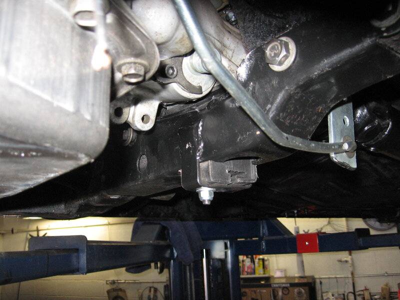

Working on 67 440 4/s purchased new poly mount but appears to tall ended up with vibration need help pinion angle continues to be a mystery, Cranky can you help

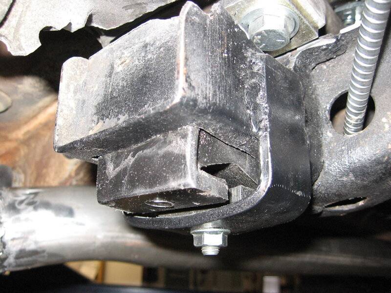

JC, Not sure you want to do this,but I did.
Rework cross member with strap to lower the mount. I cut out the base to lower the mount.Just a thought.
The top one was on a 64 Dart. The one in this photo is a 63 Belvedere
