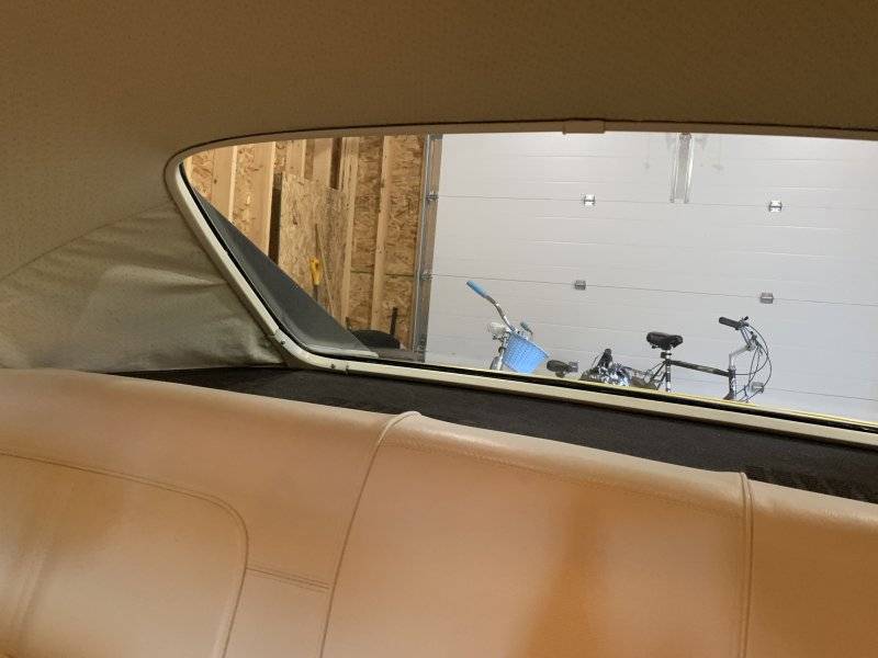

When I bought my car it came with a bunch of parts. One being the rear window interior trim brand new in the TrimParts box. Yesterday I painted them an off white and today I was excited to install them. But something wasn’t right. They didn’t fit worth a ****. And then I got thinking….. could it be? I went and looked at the tag on the box and POW! It’s for a Daytona Charger, dummy!
So anywho, do you think I could just cut them to make them fit a regular charger? I figure the ends will be covered anyway. Or am I in for some unforeseen issue?

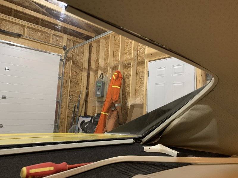

Cue the trombone….. the corner pieces don’t fit! Son of a bitch! Sure wish the originals came with the car

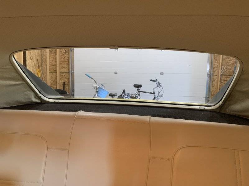

It’s been over a year putting this off but I couldn’t stand the sight of it anymore and I had nothing but time today. I still had the daytona/500 trim sitting around so I ended up trimming it bit by bit until it all fit. The bottom corner pieces don’t look real great and I had to hone the screw holes a bit to get the screws in. The little piece that goes on the top middle was already broken and broke even more when I tried to put it on so I just glued it on haha. But goddammit it’s finally on and that’s all that matters.
Those quality of how the bottom corners fit in was never that good when they were new.
