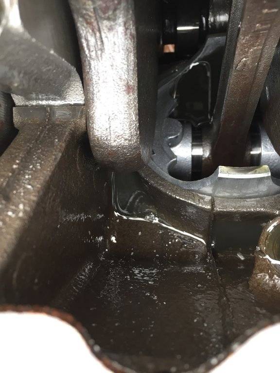

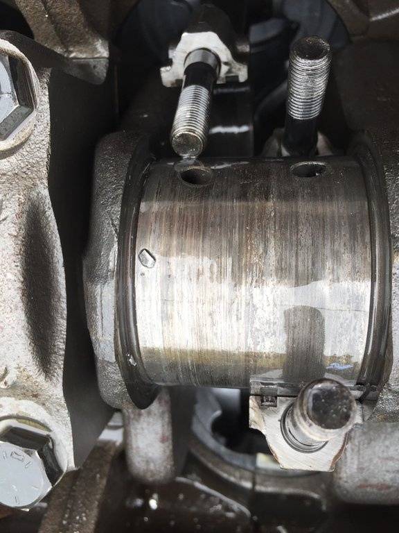

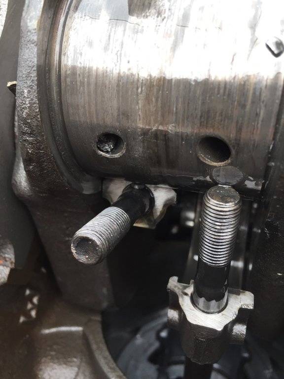

My 383 that was rebuilt when I bought my 69' took a **** a few weeks ago. I was down shifting from 4 to 2, got on it and all of sudden I hear metal scrapping together.
Limped it home, about 3 blocks and parked it.
Just pulled the engine and it spun #1 and 2 rod bearings. No knocking sound at all and still had 85 psi at hot idle. The bearing material was packed into the oil hole, which would explain the oil pressure.
So my 400 is at the machine shop getting the short block together and it'll be s 470!
Hers some pics of the damage.

I was doing about 30ish and decided to punch it, so I dropped to 2nd, nailed it, tires went up in smoke and heard a bang, then the dreaded screeching metal sound. I think I might have over revved it as I just looked at my cdi box and it's set or 9k! I'm such a dummy for not checking that when installed it.
