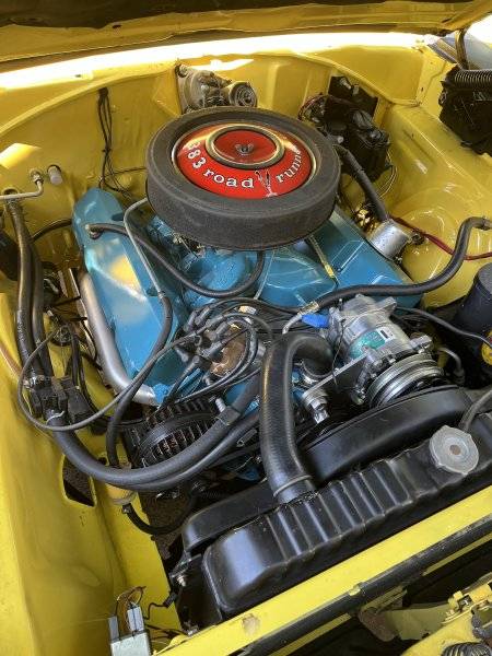

Looks beautiful - Very clean
What’s the details on the build , cam , heads intake carb ignition etc. etc.
Thanx
Thanx

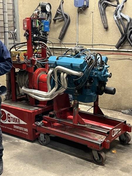

470 stroker kit from 440 source, Edelbrock performer rpm heads, full roller engine, Edelbrock performer rpm intake, Edelbrock AVS2 850cfm carb, TTI headers, FBO complete ignition set up ( coil, ignition module, distributor) I have to look up cam specsIMG_6417.jpegIMG_6425.png

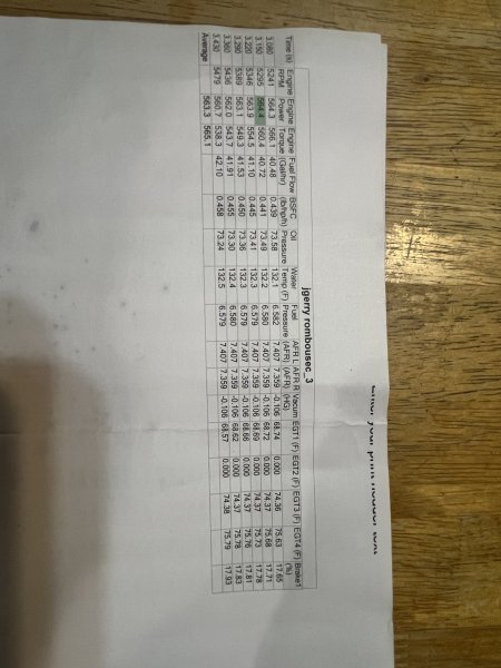

It was a nice curve, slow decline, I need to track down the sheet. We left the carb alone for now, I wanted to get a good tune once everything was together, FBO ignition, full exhaust, timing etc. I figured we could fine tune after break-in? My dyno guy said he could probably squeeze another 20 horsepower by changing metering rods, but I was satisfied by how good it runs now

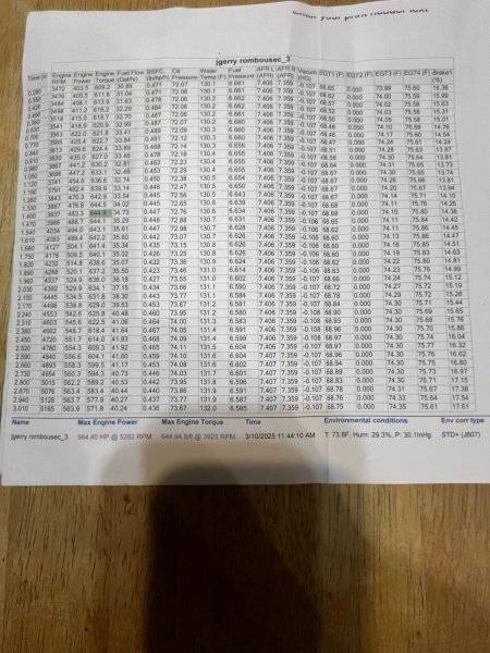

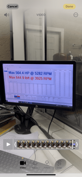

Found the r
Found the run sheets, I’ve never had an engine on dyno before so not sure I understand all this.
