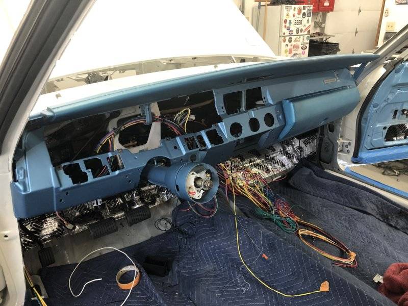

You do not have to remove windshield. I would allow a weekend to do this. Two people to handle dash is good idea. Don't forget heater controls, radio antenna connection. Awkward and heavy. IMG_0391.JPG

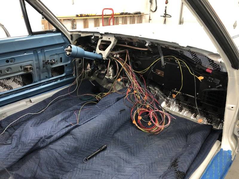

I rewired my entire car. It took a while, couple months if not a little more. I worked on it 2 days a week and on the other days made a plan for the next 2. That was key for me. Where you are just doing the dash it won’t take that long at all! But, I bet it takes more than a couple hours. The kit may fit perfectly, you may find it doesn’t go exact. Things like that will slow you down.
Lay all the new out, if you haven’t and get a plan! If it’s a kit with a new schematic, have that on hand and also have the original on hand! I don’t know how in depth you’ve gotten but unless you’re replacing your steering column the new kits may not jive with that. turn signals etc. That was an issue for me!
Any and all pre planning will cut your time down! Here’s what I had to work with! Hope th3 thoughts help a little to cut your time down. Do go slow, you don’t want to go back in!

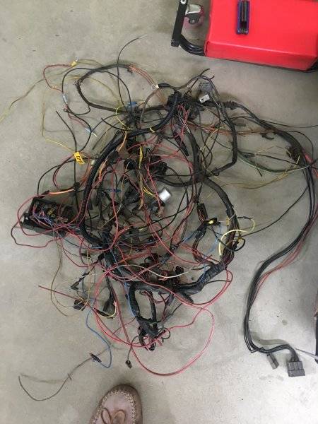

Whole car harness. Painless customizable kit. It was more organized than it looks. Mark, tag, document everything. You never know when you might need to trace something down.
