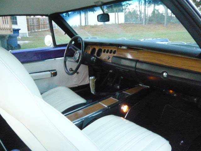

ac vents on the each side of the dash and center of dash. You will need a new dash harness also for rallye. Im not positive about the dash frame. Center pad is different too. 1st pic my 70 charger with ac 2nd is my Bee without ac.
Your not rebuilding a rally dash, you are creating one. Much harder when you don't know all the differences.
Would be easier to say what's the same! Very little.
The glovebox liner, Defrost vents, speaker, heat controls, vent cables are the same.
Also many differences per year 68, 69, 70
I'm not fully up to speed on 68-69, but some are.
