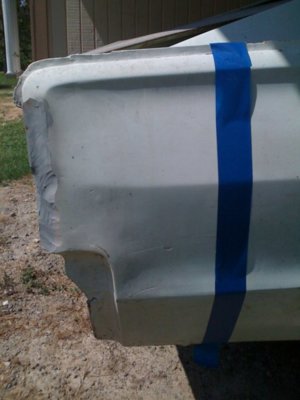

It's been a while since I've had the chance to mess with this, so I'm considering passing it to a professional. Problem is I don't want the Bondo buildup fender I already have. Any recommendations to find a replacement piece? I'm waiting to hear back from Desert Auto Parts and haven't found anything on the forum.

I have the aftermarket quarter skins but they aren't exact plus it won't cover the top and back sections.

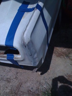

My biggest issue is the end. I have some of those quarters but it's only side sheet metal and it doesn't cover the curves. DVAP says they have one. Not rust free, but ilI'see what they have. I cut most of the Bondo off last night and this is what is left. So I think it would be a good idea for some metal back in there.

The issue with my car is the Bondo wasn't done right in the first place. It should be used at a minimum and it was used to form the body lines of the back quarter. I will use some all metal but I plan on using a bare minimum.

Your panel doesn't look that bad and you may be able to use some dollies to get it straighter and then a skim coat.
If you do go the replacement route , lucky for you the area you need is not the area that typically rusts out. Your best bet will be to find someone with a parts car and get that section of skin off a rust bucket or picked apart junkyard car that has that section in good shape.

Don't need a full quarter.
Just some patch panels would be better than a full quarter most of the time anyway.
