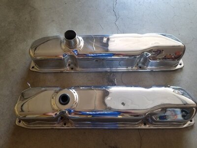

Kinda partial to factory chrome ones myself:

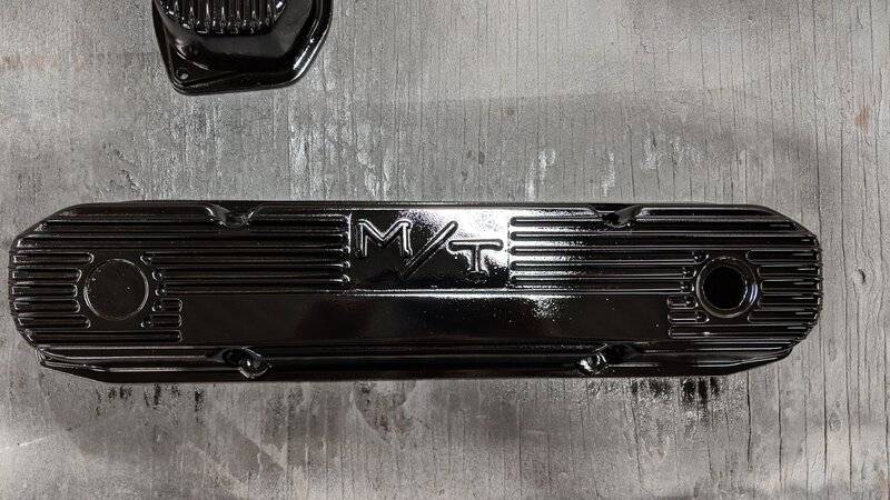

I like the Mickey Thompson , but they haven't been produced for mopars for a LONG time, even though the Chevy and Ford covers are now being reproduced (in china).
