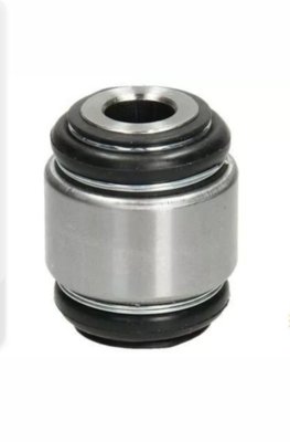

Totally agree. IF I were to build my own triangulated 4-link(still not decided..) I was thinking of using the rear wishbone bushings out of the W201 Mercedes. They are very durable, have some flex but still firm.
