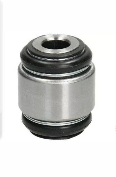

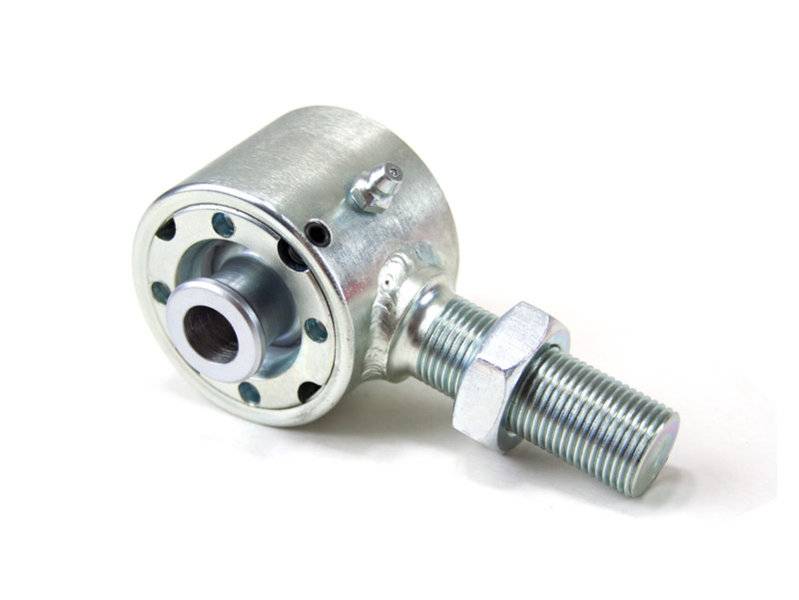

Totally agree. IF I were to build my own triangulated 4-link(still not decided..) I was thinking of using the rear wishbone bushings out of the W201 Mercedes. They are very durable, have some flex but still firm.Good read, I've been kicking around what to do with mine as well. Me personally I don't like a lot of these bolt in kits, they sacrifice geometry in order to make it fit then use heim joints over polyurethane or rubber which to me is a no no on the street.
I don't know if this would be appropriate, but I chose these to tip the ends of the UCAs on our GTO:Totally agree. IF I were to build my own triangulated 4-link(still not decided..) I was thinking of using the rear wishbone bushings out of the W201 Mercedes. They are very durable, have some flex but still firm.
Lol.Bio like these because of the way you can service them.
