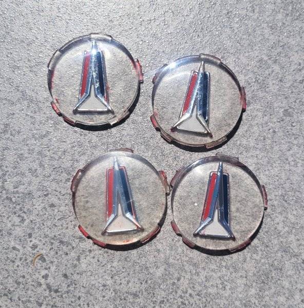

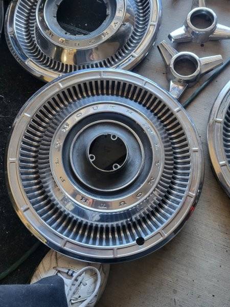

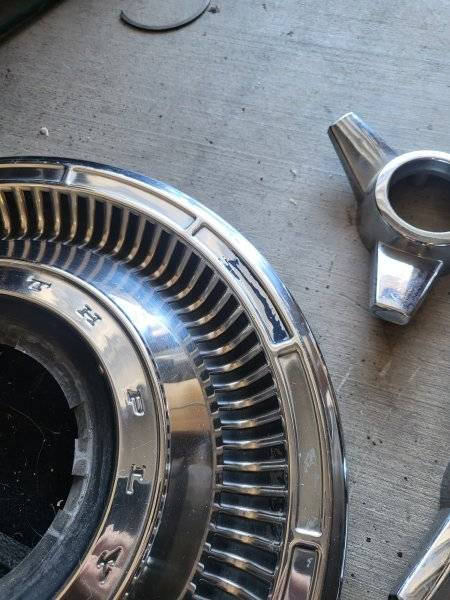

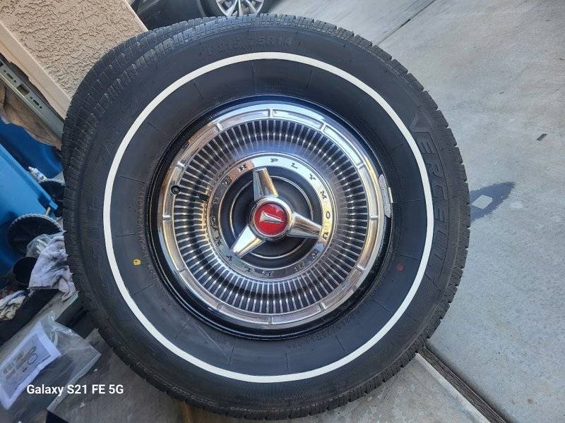

I did my wheel covers last year. Not fun but worth the effort once done.
Fortunately, I had spares to work with taking pieces from all of them to put the 4 best ones together and luckily none were dented up. So mostly just a good cleaning and polishing.
Took me a few weeks and lots of patience. Working maybe 2 or 3 hours ea day But IMO they came out great
Used a $100 bench grinder / polisher from harbor Freight and went at it

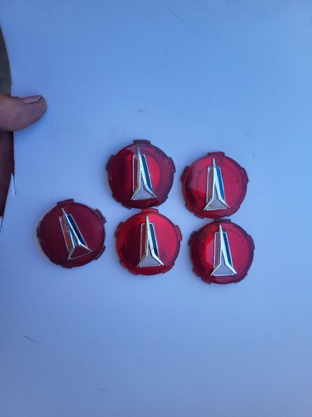

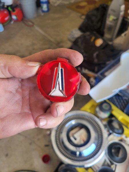

I taped them up, sprayed the area needed in low gloss black and took Q tips dipped in lacquer thinner to clear the raised spokes / ridges
Nice work. Stainless steel is great because it can be fine sanded and buffed/polished...like an automotive clearcoat, it's just a much harder material. It's easier to work with than anodized aluminum, at least. That needs to be stripped of anodizing before you can polish it up.
