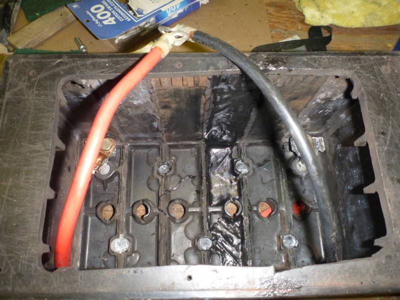

Gut your battery case from the bottom and stick an Odyssey PC925 in through the bottom of it and never look back. Heck, if you've only had it 3 years is your battery already an AGM.??? ie caps are for show and you don't fill it? If so you can probably get the case lid off and change out the AGM that's inside.

View attachment 932755 View attachment 932756 View attachment 932757
Mine took a crap too. I have a AGM inside too I think. That's what I think I will try. How do you get the case apart?
I show the entire process in my Superbird / Talladega or Bust thread Mike. It was a 30 year old script battery that froze on me and split in half. I still have another "fresh" one on the shelf that was dry charged 30 years ago and I'll do the same with it in time.

The last one I bought from Jim lasted less than two years. The one before lasted 6 years. When these things are dead you have to really cook it to get it to work, but your results may vary. I experimented with cutting the bottom out and it was very easy. Threw an Odyssey battery in it and it cost less.

Mine had two batteries sandwiched in there. Pull the caps off, you can't get to the cables from the bottom after you cut it. Small ratchet and extensions though the filler holes.
I just looked inside my 24 series Yellow cap. Through the two end caps I can see it has an Odyssey inside with cables running up to the posts. Appears it was hooked up to the top plate and then the battery lowered into the case that had liquid epoxy in the bottom to bond the battery in place. Lid seems to be bonded down as well, so as chtampa states it looks like a bottom entry like I did with my old acid battery.
Since I have 2 "Red-Cap" carcasses in the garage now, I think I'm going to attempt a "Heart Transplant" on one of them as some of you have done/suggested. Just out of curiosity … what did you use to cut the bottom out of the battery? AND … Did you seal it back up … or did you use just the Plexiglass/Lexan and screw it on?
Since I have 2 "Red-Cap" carcasses in the garage now, I think I'm going to attempt a "Heart Transplant" one one of them as some of you have done/suggested. Just out of curiosity … what did you use to cut the bottom out of the battery? AND … Did you seal it back up … or did you use just the Plexiglass/Lexan and screw it on?
I show the entire process in my link in post #10. Was a bit easier with a battery that was split in half from freezing, but the end result is the same. No need to "seal" the bottom of the case, the Odyssey battery is totally sealed.
