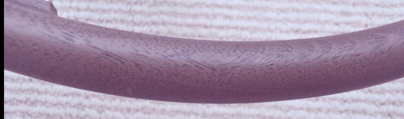

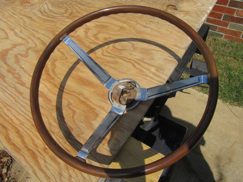

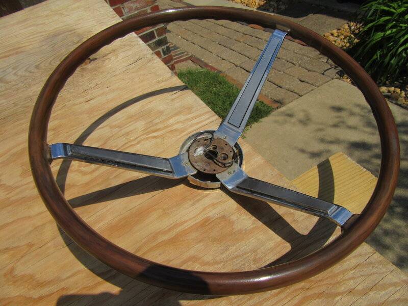

Heard some use a hacksaw drawn to make grain. Seen some hack jobs. pun intended. Some pictures of an NOS wheel sold on ebay $1225.

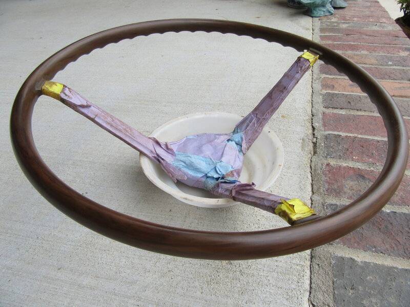

Here are a couple pictures where I'm at. This was the first coat I applied of light brown. Even after 7 days this wasn't completely dry which worked against me in the next step.

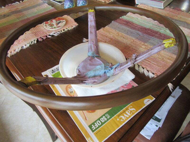

This is the second try at adding some color variation. Not too satisfied as it isn't as good a pattern as I had the first time at this point. But with the slightly wet oil paint from the first coat every thing I put on it tended to blend together. I couldn't do much more with it until it dries as I didn't want to get it too much darker at this point.
I'll let this dry thoroughly and use a fine brush to work in some dark grain swirls and streaks (I hope).
I'm done with the coloring phase. Next step is to apply some clear urethane after a few more days drying. Cloudy day - color looks better out in the sunlight.

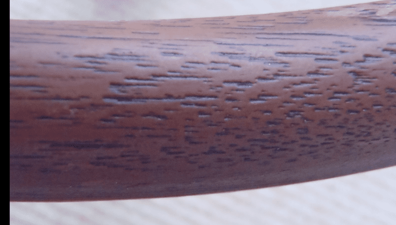

Done with this project for better or worse. Applied 3 - 4 coats of 2K clear which should protect it from wear. Spokes on wheel are fair condition with a bit of rash in the center satin areas. The bright chrome is pretty good - just need to clean up a little.
