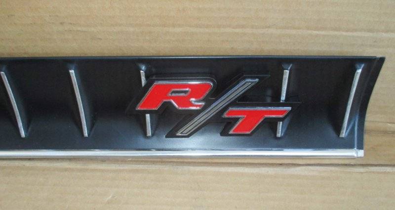

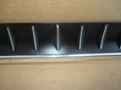

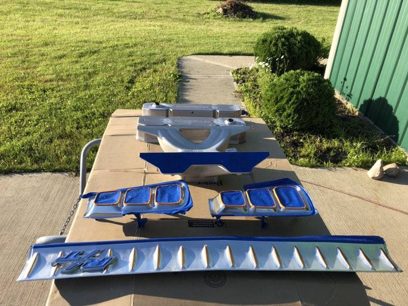

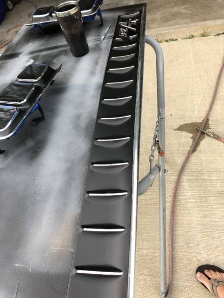

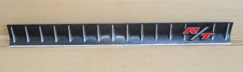

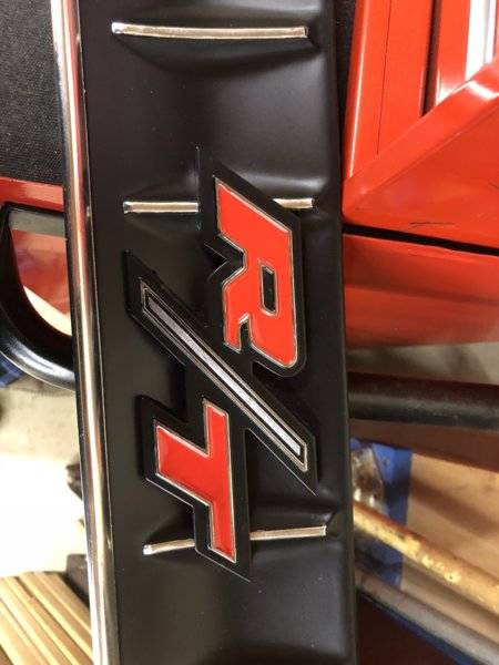

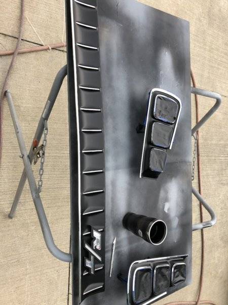

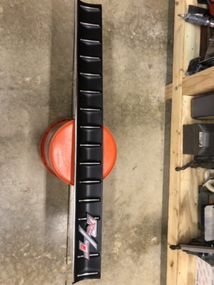

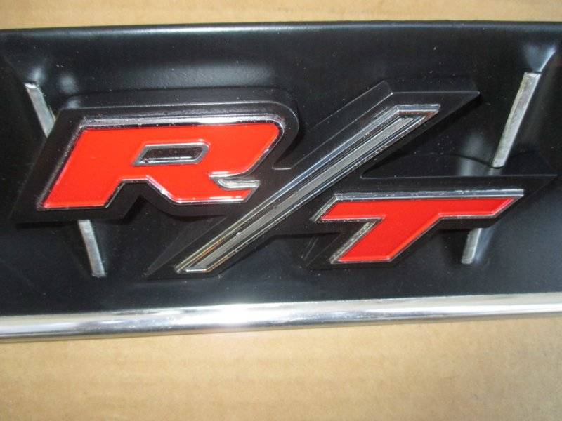

Been goofing around with my tail panel on my coronet over the last several months.
It was in pretty good shape with just some scuffing on a few fins. Not bad enough to warrant a reannodizing IMO. I drive my car, so presentable is fine by me.

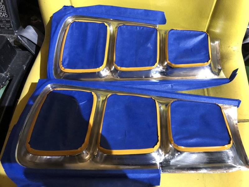

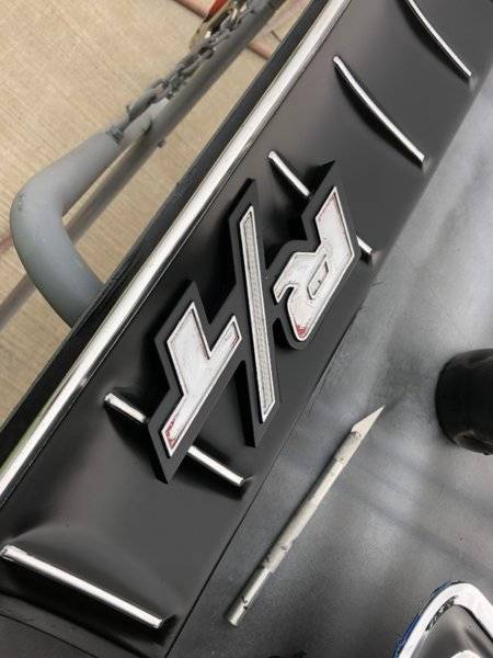

I stripped the old chalky black off and massaged the scuffed fins as best as could be. Then I masked off the fins and the anodized areas with 3m fineline tape.

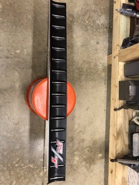

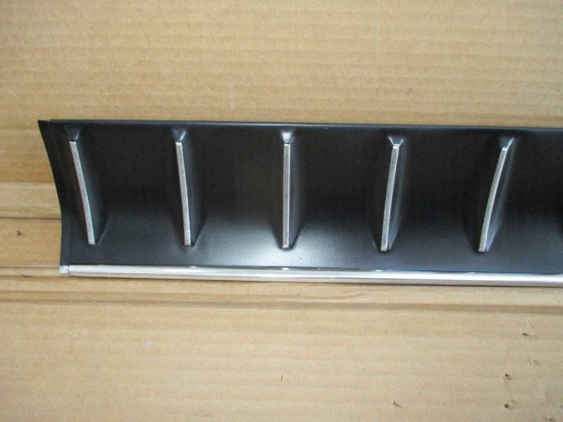

I used SEM “trim black” shot through an Iwata trim gun to refinish the black areas. Pretty happy with that product.

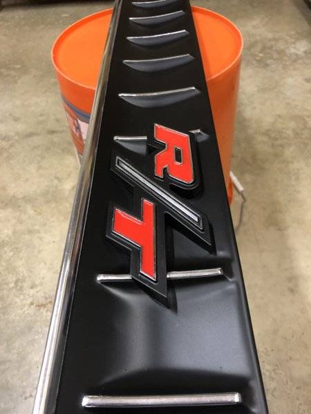

The red in the RT emblem is a mix of Testors Flat red, orange and gloss medium red. In the pics it’s just applied so it will flatten out some as it dries. I thinned the mix a bit to get it to flow out some.
Overall, I’m happy with the results. It shows way better than it did.

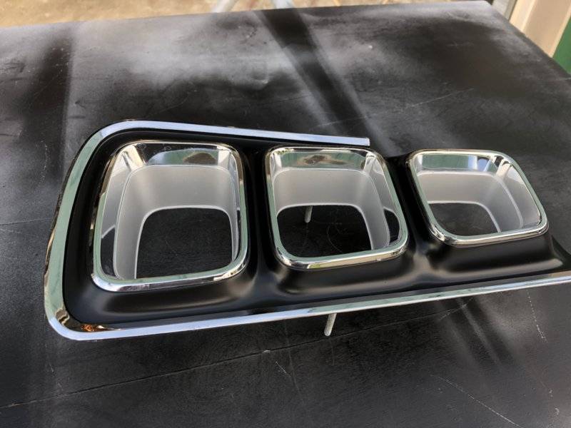

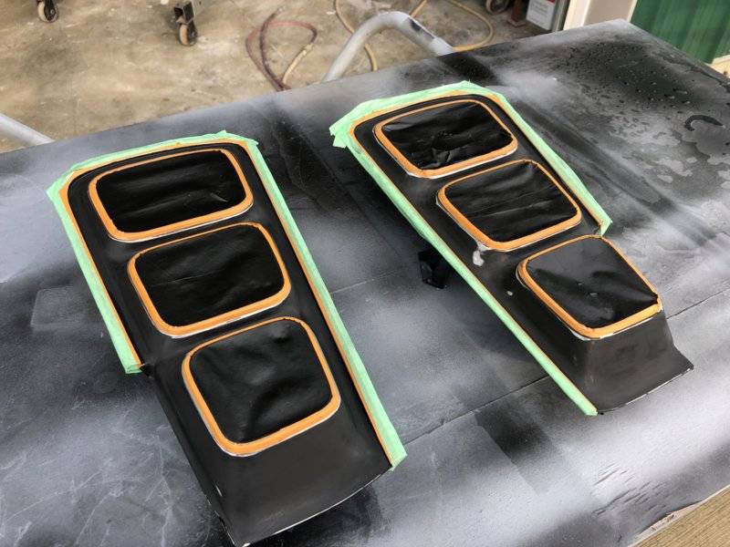

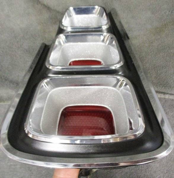

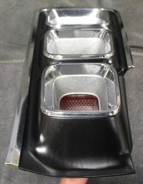

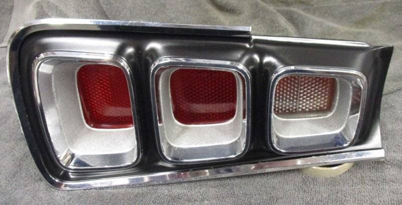

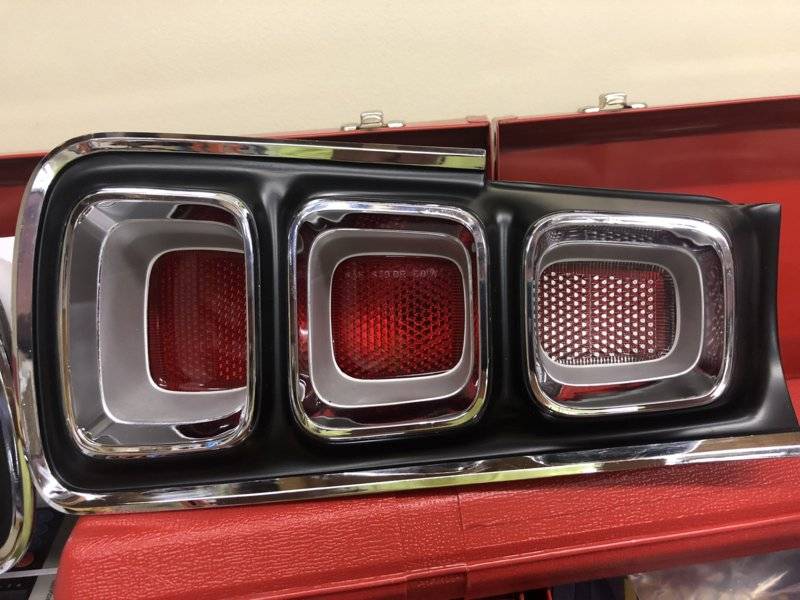

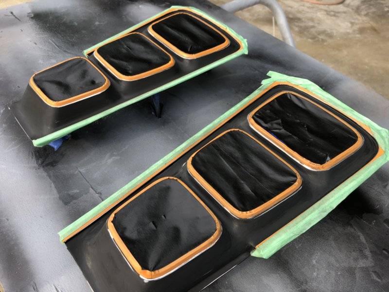

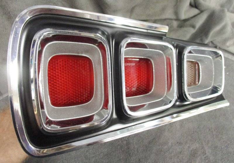

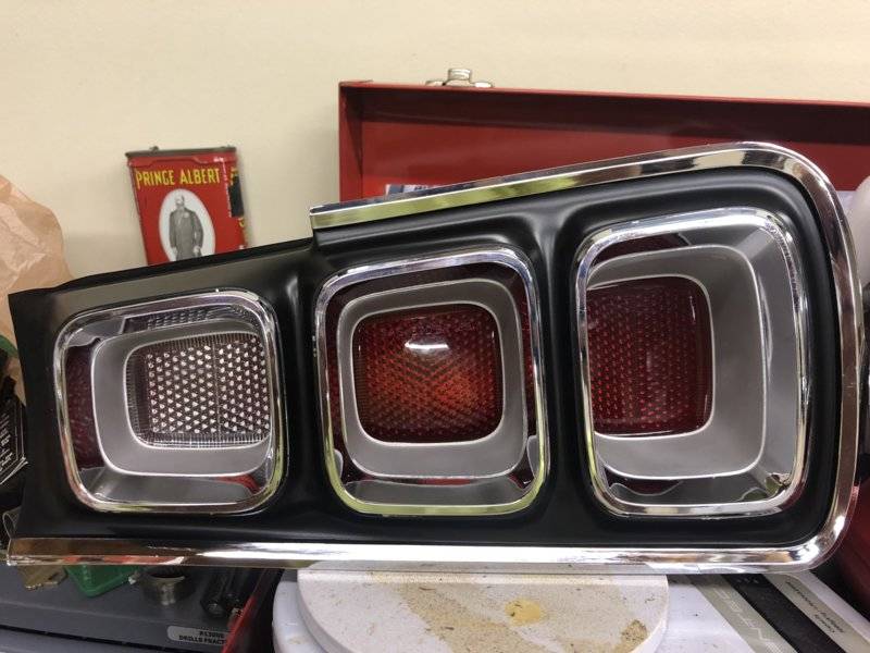

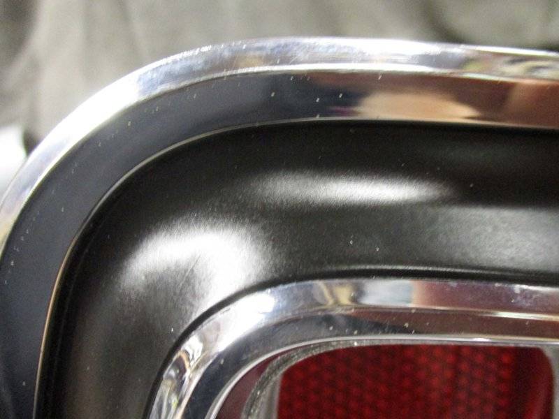

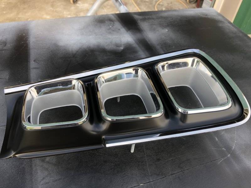

Also did the tail light at the same time.
The chrome was in perfect condition without a single pit.
Same products and application on the tail lights.

I've always loved the styling of the back end of the 68 R/T's & yours is looking great....
Nice. Sweetest rear panel and lights ever.
