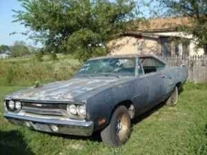

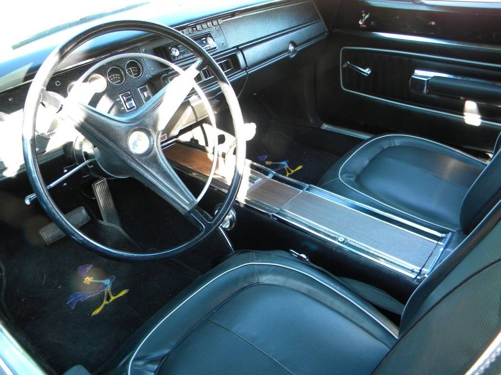

I did mine and it is well worth it! Take your time as I did and shop ebay. I think I might have had 1K in mine. But took about a year to collect everything. My superbird was a satellite and I collected parts for 3 years before I started my build. Just be patient and watch for parts. Mine was a sweep dash column shift bench car to start with.
It is a lot of work but very cool when you can go from this.
To this doing everything by your self.
Did you do the cluster overhaul yourself?

Actually that is original. I found in a salvage yard laying on a shelf. Story is it came out of a wrecked charger. Odometer had 19K showing. I paid 200.00 for it.

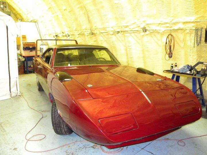

Thank you for the guidance! Great job on your Superbird! I love the red.. so currently, I purchased a completely restored Rallye dash with all gauges by a Member of this forum about a year ago....and planned to remove the classic dash, and replace it with the Rallye one... when I bought my donor car, it came with everything and then some, including a new dash frame, I never thought I would need it, but now thanks to you, I see why... It looks like a lot of work! I'm finding that there's nothing easy in this build, but I'm making progress....
That's sharp! I want to change my column shift to console too. I've got some of the pieces on order. Still looking for the rest.
Can you tell me about your nose? Is it steel, fiberglass or original? I bought most of the nose pieces from Gean Gregory. Now I have to figure out how to put them on. I'm looking for info on that, even an exploded view would help. Do you have any source of info on that?
