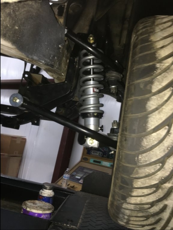

Haven't used them yet but I'm going with their street lynx rear 4 link set up on my 67.
I have only installed there front end kit. Best thing I've done, more than a world of difference in the handling department and braking department where I upgraded to the wildwood disc brakes with there hydroboost system. I plan on installing the rear Lynx system this summer.

I bought the alterktion front end. It lined up perfect and performs like it's on rails, just ordered the street lynx 4 link. For next summer. Love it.
As info to anyone looking to order the street lynx there is a 3 week lead time.
