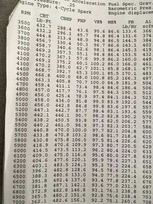

This 383 used a solid lifter cam.
The cam has less lift, and has less high lift area than the cam used in the HR article.
The cam is not a .904 lifter design.
(Look at how solid the power is still at 7k)

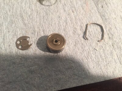

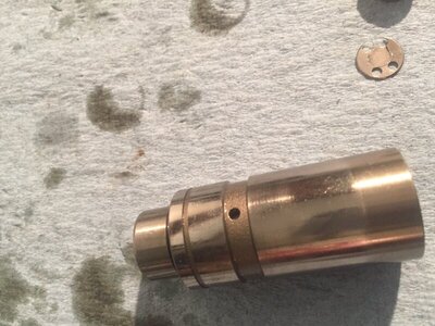

Probably about 8-10 years ago I did some repairs on a set of iron BB heads, and sold a customer a cam for his 446-6.
What I tell people who are wanting to use the fast rate .904 cams is, they will make good power up to the limiting rpm of the valvetrain...... which, if you’re running adequate spring loads ends up meaning the “lifters”.
So, he was on board with that.
He got the same cam used in the HR article...... the XE285HL.
The car runs strong......has gone mid-11’s in a full weight 70 B body.
But...... it won’t go over 55-5600.
This spring it developed a loud tick on one valve.
The hammering finally killed the lifter.
