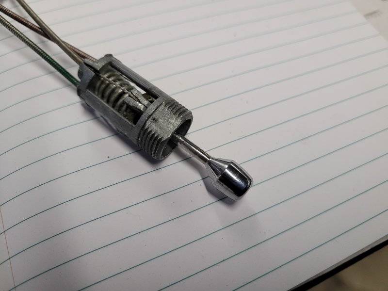

Need a nice STRAIGHT mirror control knob for the door rebuild. This one wasn't as strong as my arm!

Believe it or not you can straighten that very easily… I have done quite a few..
I taped the shaft part and tapped it down with a hammer, very lightly. Then rolled it back and forth tapping it.. untaped it and it wasn’t even nicked.. I used a solid piece of steel in my vice that was only wide enough so the chrome ball end and the threaded end never got touched… Hope that explains it well..
Thanks.. it does indeed unscrew from the 3 cable head correct?!
