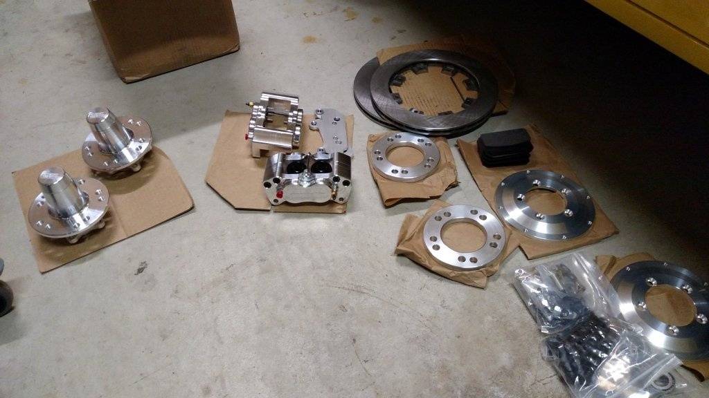

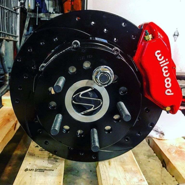

That's a nice kit, If you don't mind could you give me some specs on on tha kit, rotor diameter, rotor thickness, and price if you don't mind? Send me a pm if you don't want to list the price here

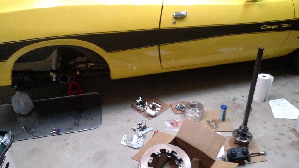

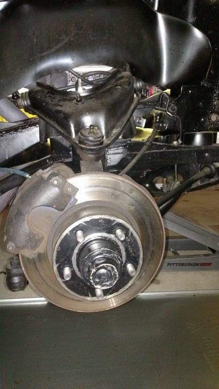

I know the feeling, I started off as a heads and cam swap, now I have a 505" being built, 4 link rear, 4 wheel disc, roll bar, new strange s60 with 4:10's, fuel injection, new wheels and tires I'm sure I left plenty out too lol. Domino effectFinished the front completely and just pulled apart the rear tonight. Still have to install rear and master cylinder ....ugh honestly don't know why I decided to do so much at once

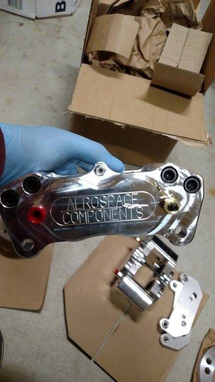

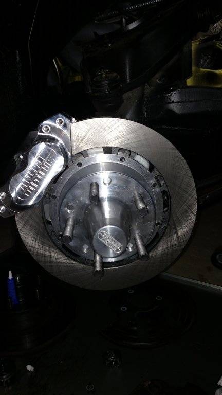

I didn't use any, strange s60 came with a foam and paper gasket, plus the wilwood caliper mount acts as a seal. Have you thought about painting the lettering on your calipers, maybe yellow or black to make them stand out a bit? I think that would look good!Wow that looks great! I'm gonna do the same, makes sense and will match the front.... Where did you use rtv sealer ? I have sealed bearings but they said use it just to be sure. I'm thinking on the caliper to axle housing bracket ? Or right on the bearing?
Just use a fine tip paint brush, that's what I'm using to paint the engraved lettering on my master cylinderI would actually really like too do them black. The only thing is they are engraved instead of cast so it would be difficult
When I tore apart my 8 3/4 with tapered bearings there was rtv all over

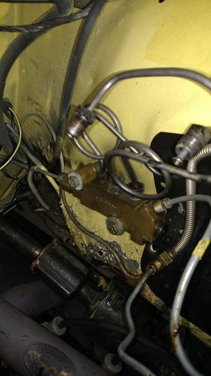

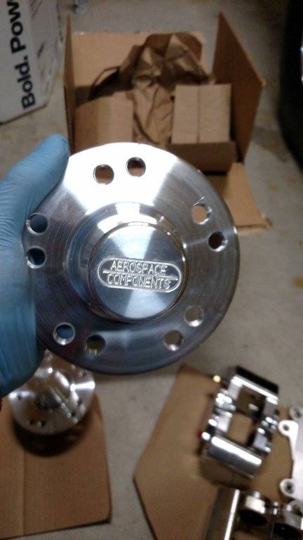

Yes that is the proportioning valve, if your kit comes with a new one it is no longer needed.Stupid question, is this a proportioning valve? Also does it have to come out now since I went from rear drum to disk? Aerospace has a built in proportioning valve in the master cylinder and recommends no others . View attachment 425427
