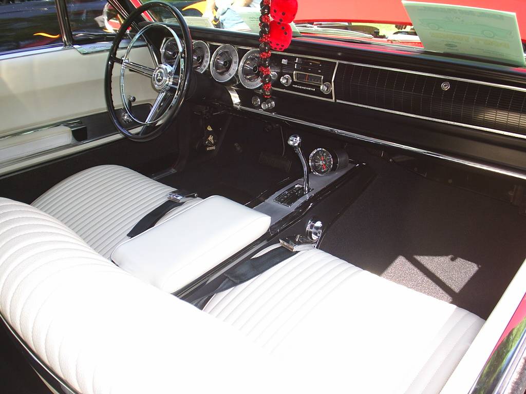

It should be just the brushed aluminum plate under the woodgrain which sits over the ribs like on the 66-7 Chargers.
