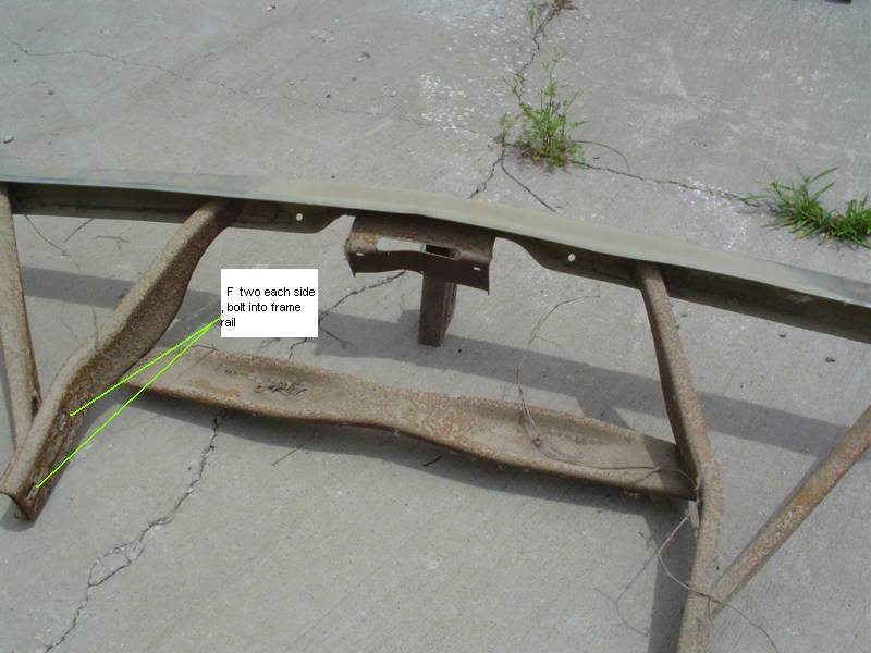

Remove the two bolts on each end of the bumper that attach to the fenders then remove two bolts per side on the frame rail that attach the bumper brackets to the frame rail. The frame/ bracket bolts are accessible from the wheel well pull the bumper along with brackets forward off the car. Here’s a pic I borrowed for reference

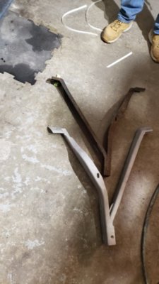

Just removed the entire front end and it took some time.
Thanks everyone. I managed to remove everything. And niw I can begin restoration. I also was able to sandblast.
