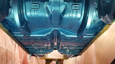

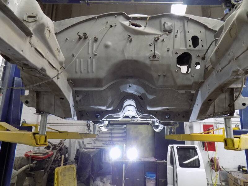

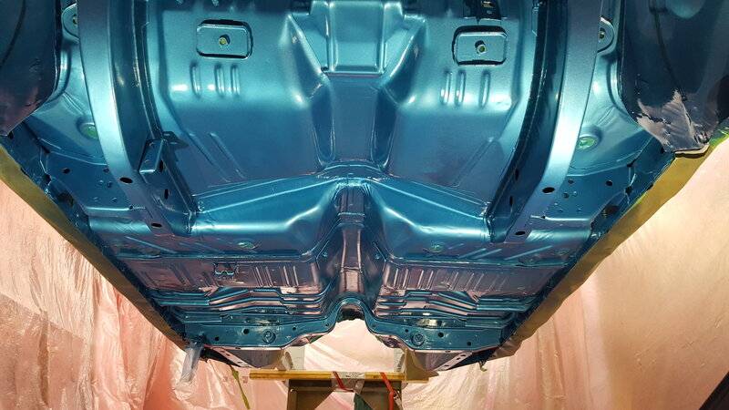

I did this as an experiment the past year in my collision class on my 69 RR conv. Many of the ideas already listed from above replies. I did use a two post hoist and not a rotisserie. I bought two light LED on stand for vision helped greatly. Needle scaler (went through 3 all Harbor Freight) to knock out large chunks, Used Aircraft brand Paint Stripper (aerosol not as strong as in a can), brush on in little areas, so doesn't dry out. Overhead can be messy as it drips. Putty knife (rigid type) and Wagner heat gun. I did use air chisel with large blade for areas I knew I would not damage. Used 36 grit flap disc on grinder for flat areas and wheel wells and sometimes a wire brush on a drill, and then pressure sandblast. I then finished with gravity feed blast and used razor blade and long flat screwdriver to find the small stuff. Make sure you remove the seam sealer as well as I found often surface rust underneith. Trunk pan was replaced so that saved some time. I experimented first on fender and fender rails first and because was mostly flat, paint stripper worked best there. We have huge sand blaster so finished that inside of it. Going to use epoxy primer then Raptor tint-able bed-liner to match car. Looks good in trunk. Needle scaler for majority of project but watch air pressure. Roughly 50 hours work. Wear dust mask and gloves. Took a fresh air supply from a paint hood and converted to a blasting hood for blasting purposes kept cool that way. Good Luck! School closed for virus so now I sit

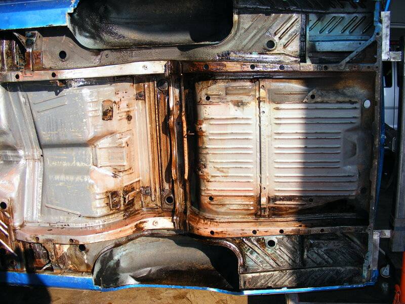

I've found hidden rust once the undercoating was off and some of the rust wasn't pretty. If it was applied well and it didn't crack open, then you're good....
