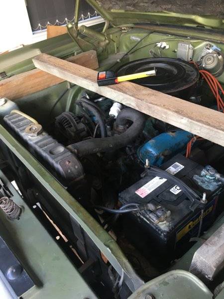

Question. Can you, without potential damage to your inner guards, take the weight of and suspend your engine under a beam and remove your k-frame without having to pull the whole drive line? I’m needing to replace suspension bushings, engine mounts etc and repaint it all. The photo is with some odd bits wood I had laying around just to illustrate what I had in mind.
It can be done. Pull the steering column, disconnect the upper control arms, power steering hoses (if it's a P/S car) unbolt the motor mounts, brake lines, Torsion bars shocks and the 4 K frame bolts the whole front suspension will drop out. I think your idea will work, I'd make sure I had the car stable on some good jack stands. Good luck and be careful :thumbsup:

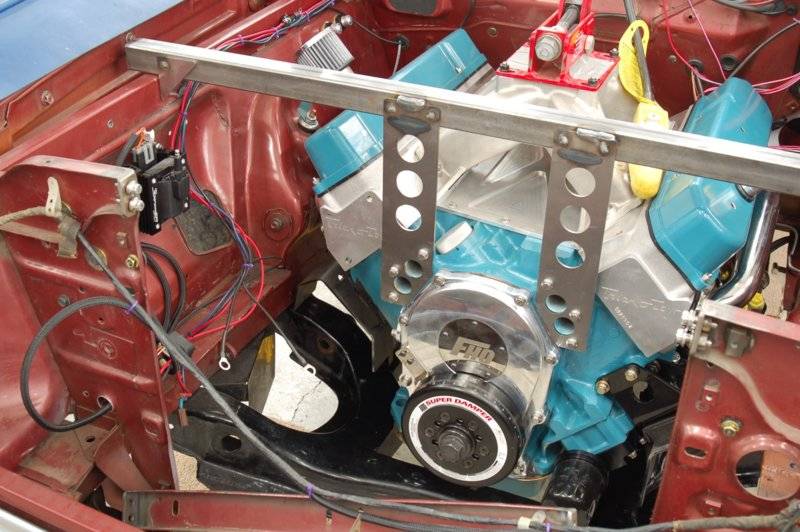

I took the k-frame and front suspension out of my Belvedere and left the engine in place. We made a jig that bolted to the water pump bolt holes in the block and supported the engine on the front frame rails.

Not sure that what you're planning is the best way to go about the job.
Thanks for the helpful input. Food for thought. Wanted to get all the suspension and k frame sorted and painted before sometime down the track getting stuck into the engine and trans. I’ve got the trunk pan to replace and rear window leaks to address before that happens though.

I have been working on the K frame in my Coronet so I fabricated a support for the engine. Pretty simple fab job.
