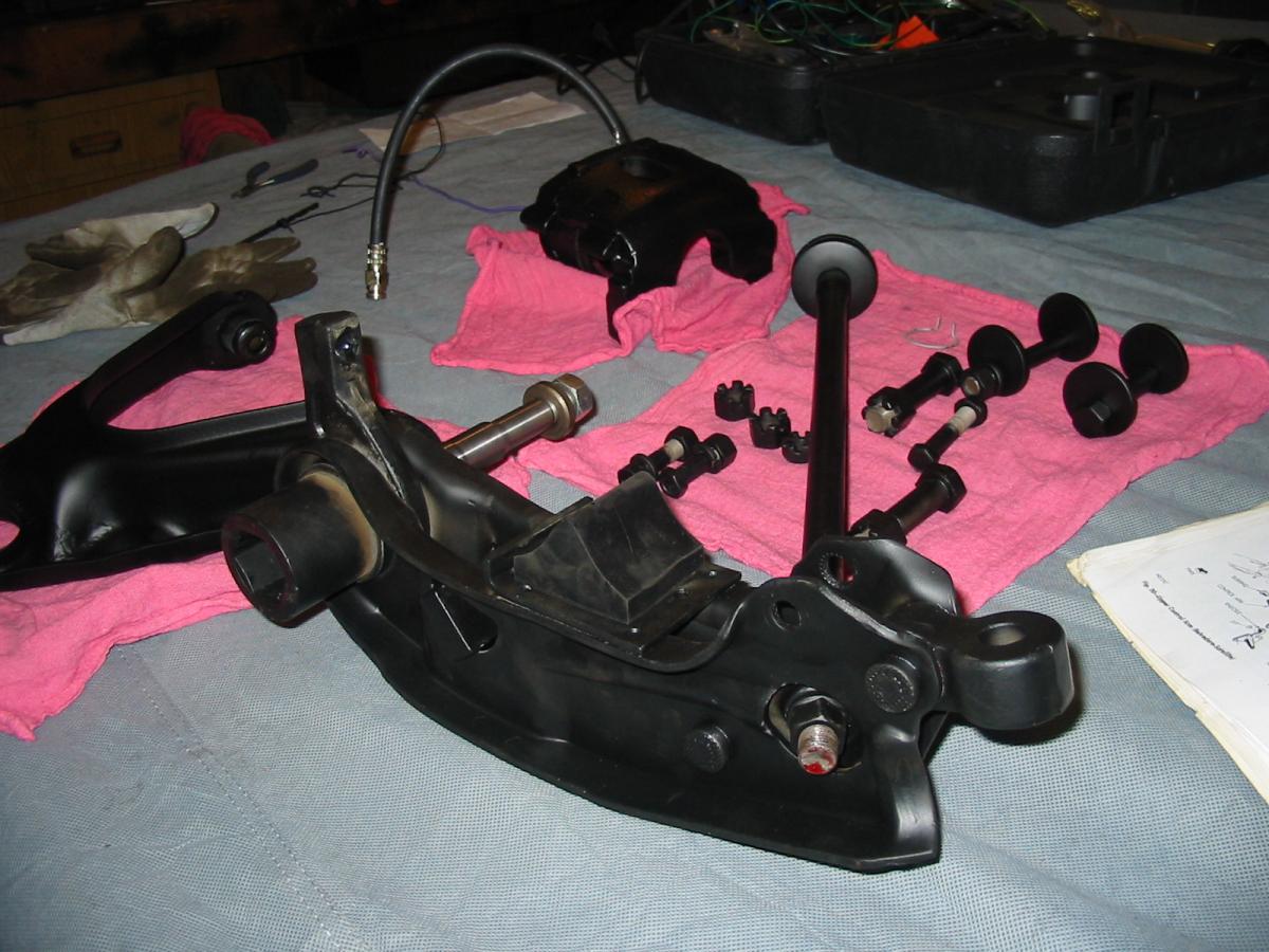

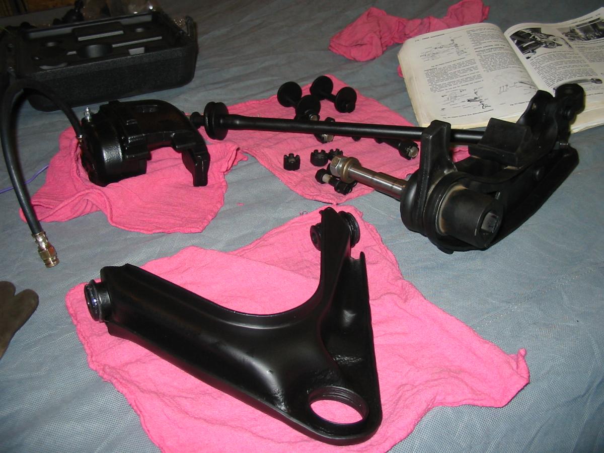

I am working on the front end of the Satellite and am installing a PST poly kit. The poly kit comes w/ both poly and rubber LCA bushings. From what I read off the Firm Feel site if you use the poly LCA bushings you need a set of adjustable front struts to insure positive caster and a stable toe setting. Guess this explains the tire wear on the Belvedere as I used the poly bushings w/stock strut rods.That being said I am using the stock rubber type this time and just spent about an hour with a punch and chisel removing the old outer shells. Anybody got a better method before I start round 2 on the other side?Heres a couple pics after I blasted and powdercoated the pieces and now have them ready to reinstall.

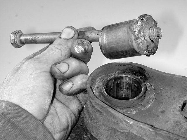

Make those small cuts all the way around, bend them in, drop a big washer inside, then weld tabs to the washer. When the weld cools it will shrink the sleeve, maybe enough to hammer out or take a threaded rod through the sleeve and a bigger diameter pipe with another washer and screw it out. I'm lucky to have a press so I push on the washer through the pipe. The weld shrinkage really helps.

When I did mine, I welded a washer to the shell and used a press to get mine out. Worked like a charm. Mine were so bad, they fell apart once unbolted. I believe I gat the idea from the Mopar Muscle tech on their site, as shown in the above post.
