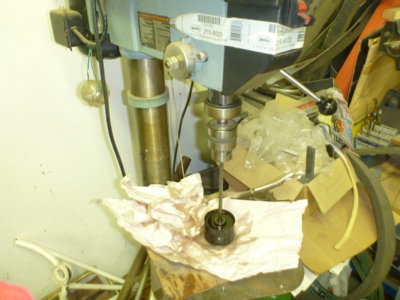

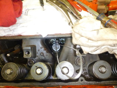

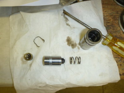

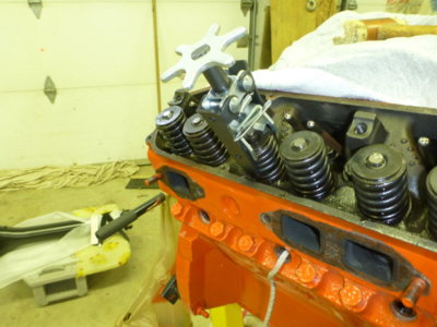

No need to buy anything, just grab a length of TIG filler wire or anything similar with some spring to it and sharpen each end to a point. Did my full set to check them all for leak down when I was installing new valve seals, by using the good old rope trick. Just have a magnet stick ready in case you drop one...
