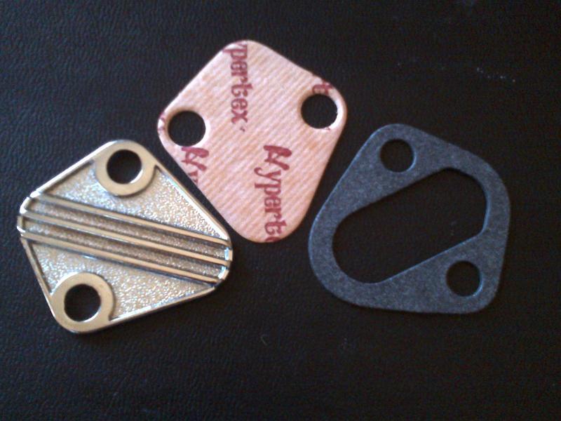

I am removing the mechanical fuel pump off my 440ci and was going to be installing a Holley Block-Off plate.
The plate came with two gaskets.
Do I need to use some permatex gasket adhesive or just the two gaskets provided in the kit?
Also, which gasket goes against the engine block first? The black one or light-colored one?
Thanks,
watermelon
You use one or the other not both. The solid one would be the one i used.
I agree....Why create another gap to leak with the addition of a second gasket. Only RTV I would use would be a light film to hold the gasket in place, while weaseling in the two bolts.
I would simply use a film of high temp RTV. A fuel pump block off plate is considered pretty permanent. I wouldn't want a gasket there to soak up oil and possibly leak down the road. I would use RTV only and on the bolt threads and a dab under the bolt heads as well. It will never leak if you do that. That's how I WILL do mine.

will toss the gaskets and go with the high-temp rtv as RustyRatRod suggested. i don't plan on re-installing the mech fuel pump.
