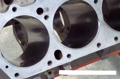

I see in your post you said...so hopefully all the m/w gear(heads and manifold) will bolt straight on with no probs.
Someone correct me if I'm wrong but all original max wedges have exhaust valve reliefs (eyebrows) in the tops of the cylinder bores. They aren't very big reliefs but they are a must have on an original max wedge of any year. Exhaust valves were so big they didn't clear the block without this machining. I think this is still required if using a 440 block.

hi fury, yes that's the only thing I thought about checking. As the 440 is 30thou over I'll get some plasticine and put it on top of the pistons in the exhaust valve area and rotate the motor and see what sort of clearance there is, may need to notch the top of the block, may not. I have it all sitting together at the moment and it looks awesome....

Just like this.

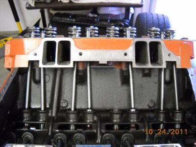

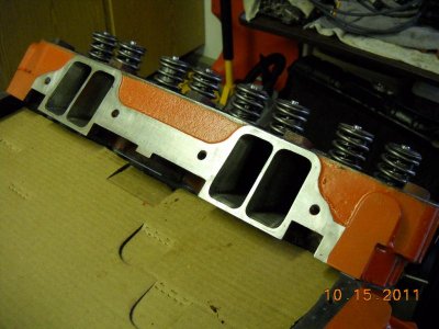

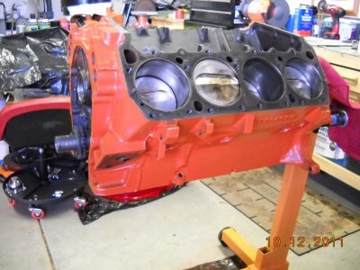

Furyus63: See attached pictures of my standard bore 440. Utilizing Felpro #8519PT head gaskets, I didn't need to notch the block for my max wedge heads. However, the advice to check your motor is correct and will give you peace of mind.

Good information to keep. I'd never use the 320 degree, .520" lift cam on the street. But with a 1.88" exhaust valve would a .520 lift require a notch with a 440 block?
The photos of your max-heads just makes me want to go find another set just to put on the shelf and look at them.
