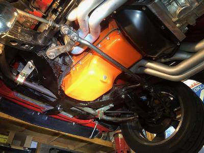

This is my 6 quart Milodon pan.

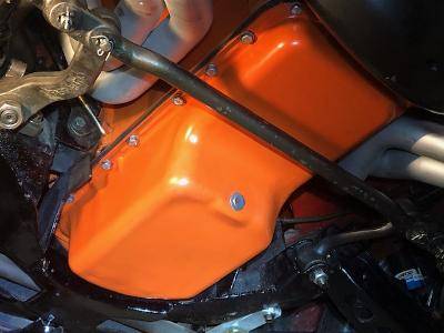

You can see that the pan can't move forward or back because the engine crossmember (Known as a K member) blocks the front and the transmission flywheel blocks the rear.
The steering link has to move to allow the pan to come out. You can do this without lifting the engine but you'll have to disconnect the center link at the Pitman arm and the Idler arm. From there, the linkage just lowers away and allows plenty of room. The oil pan then should be tilted down at the rear and then rearward away from the engine. You may need to wiggle it side to side a little.

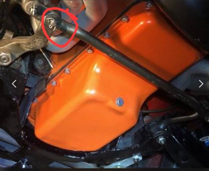

This where I remove center link?
The red circled spot is the Pitman arm. That is one. The Idler arm is on the right side. It needs to come loose too.

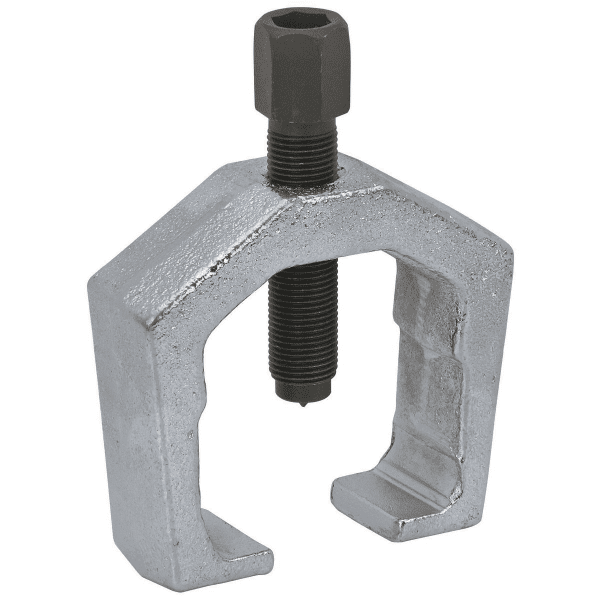

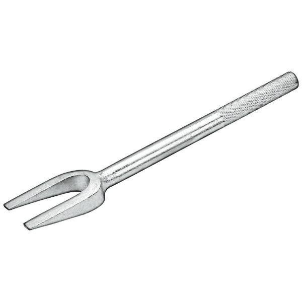

Some just remove the cotter pin and 3/4" nut, then wedge a "Pickle Fork" in between the center link and Pitman-Idler arm.
This works but often destroys the grease boot. A "Gear Puller" also works.

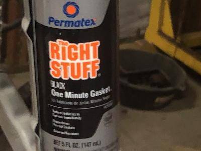

On the 383 in my other Charger, I just used Fel Pro gaskets and this sealant:
It is not cheap but it is the best that I have used. The 383 barely leaks anywhere. The engine from my red car does a bit though. I'm working on that though.

So with the sealant do u put gasket on pan and bead on top of gasket or do u bead both sides of gasket? N u recommend some blue lock tight for bolts?
I just pulled mine last week and used the puller in Kern Dogs post 10 above on the idler and pitman arm. I usually tighten the puller some, strike the bolt head with a hammer, tighten a little mor and they usually pop off pretty quick. The grease seal on my idler was torn and I got a replacement from Detroit Muscle Technology.
