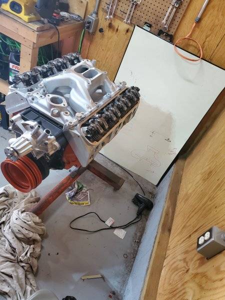

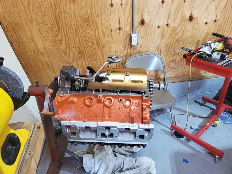

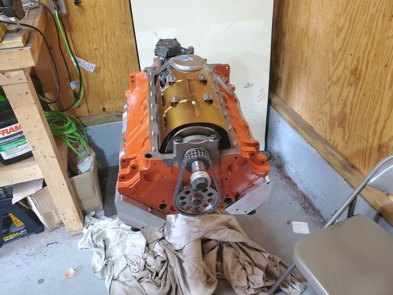

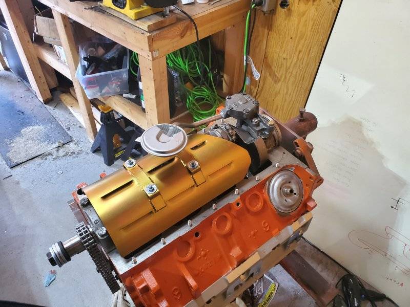

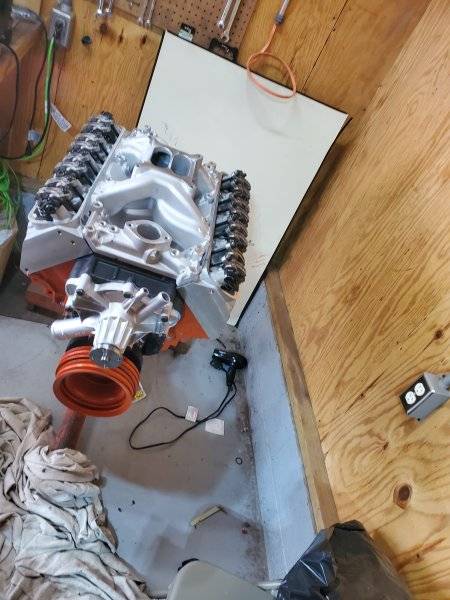

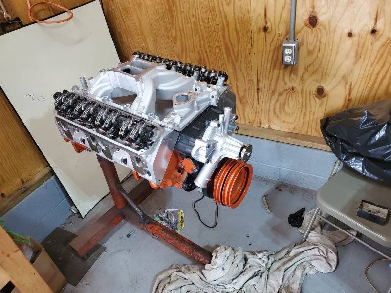

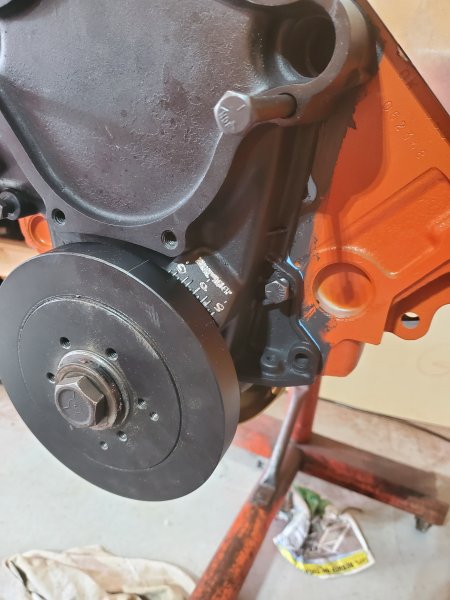

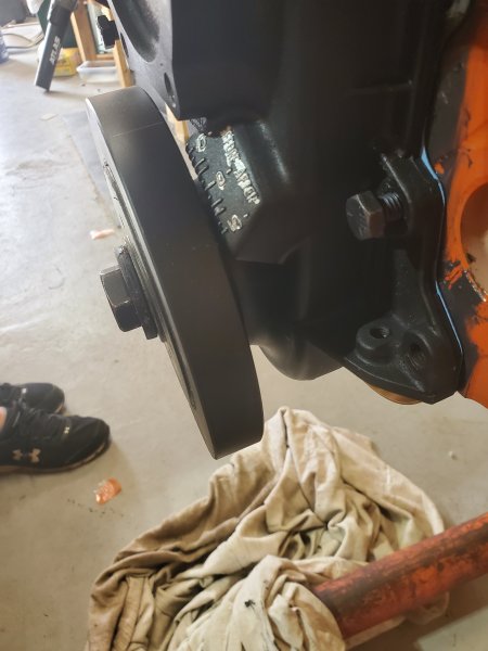

I'm an idiot guys. (If you haven't guessed by now.) Got the windage tray all move up. Got the damper in and just needed to push it in all the way. It fits perfectly. Did run into an issue with the cool gap intake. It dosent lign up very well. It's the jegs branded one and I do see alot of people are having the same issues as me. I'm going to try and use a thinner gasket. And see if that helps at all. And if not. I'm going to blow out the bolt holes to be able yo get the right angle. It's just cheaper and easier than buying a new intake as well. I'm also unsure what jegs policy is on returning parts that I've already tried fitting. It's got some gasket juice on it and suck. I'm sure I an clean it up nice. But I'd rather just open the holes up wider to fit. Any ideas or imput would be appreciated.

looks good.. just don't rush and miss something
You really went to town there
Turn the crank to see if tray rubs?
Check clearance between balancer and water pump?
Trial fit oil pan to see if it clears tray?
Put intake on bare, and take close up pics of said bolt holes?
