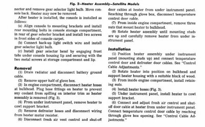

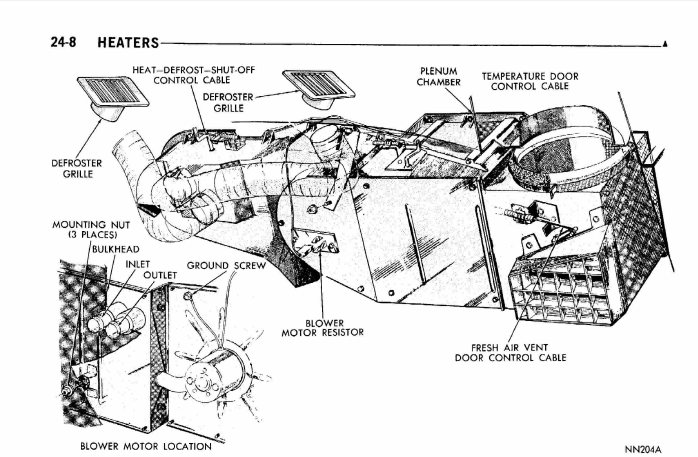

I know it sounds really easy, but is it really as easy as loosening the three bulk head nuts and the box should drop down? Or will there be some wrestling to get it separated from the bulk head? Does the glove box need to come out?
This is for a '70, should be about the same.
No glove box is fine, 3 nuts and 2 hoses, 1 nut frontal tab support, 2 clips for cables (hopefully not held by screws) and vent hoses. Should wiggle out with some antifreeze spill !

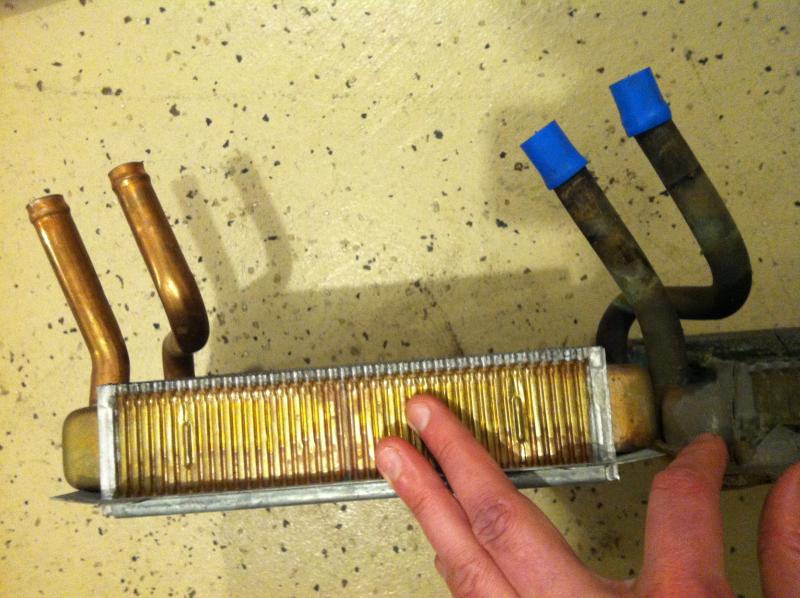

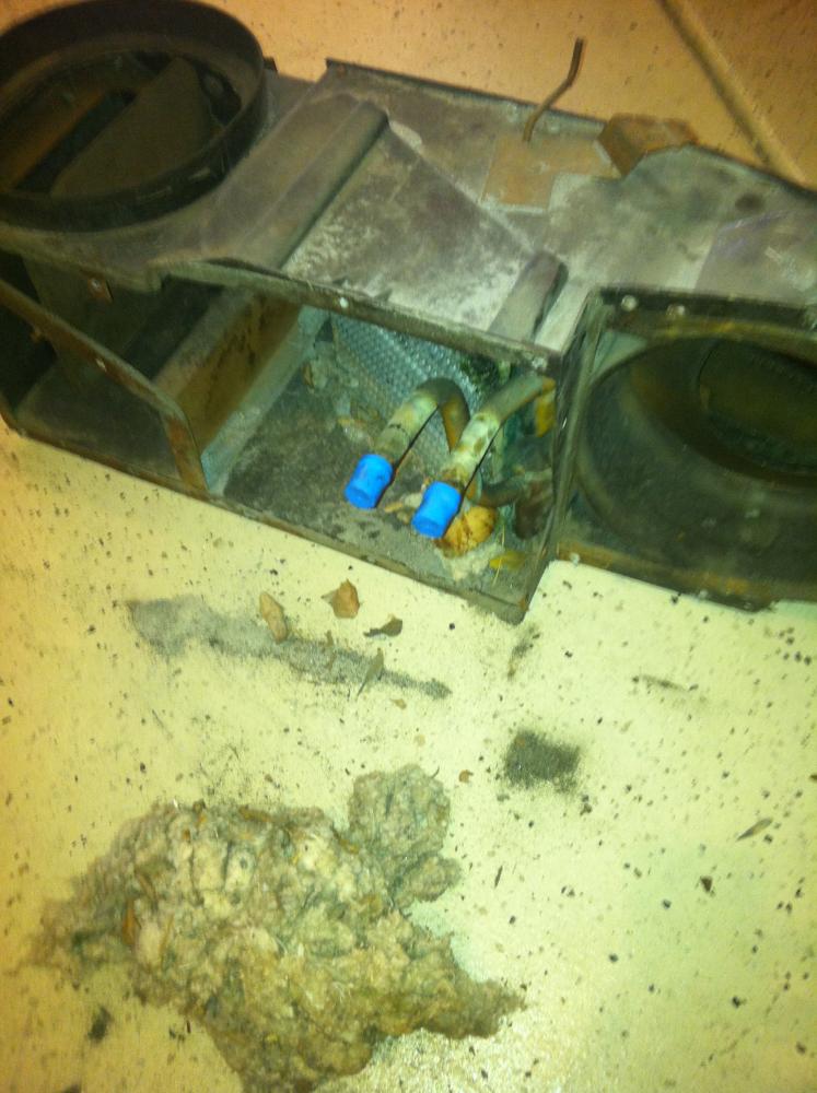

Got the heater box out, and what a mess it is!! Nice lil mouse house in there. Lots of work to get it looking "new" again. Got a new heater core from Year One and compared it to what's in there and its a perfect match, including heater hose outlet lengths.
Picture comparing YO heater box with box from car.
don't know the fascination with mice building nests in heater boxes but it is almost 100% that there will be one there.
And so my heater box is coming back out. Struggled with getting the heater hoses on the new heater core, and thought they were on well enough. But slowly over the past week of driving the Bee I noticed the corbin clamp slowly turning and when I went to try and loosen it and readjust it the hose started coming off and of course it finally popped off spraying hot coolant every where (luckily was prepared and avoided it). Tried putting the hose back on with failure and eventually broke off the YO heater core tube the hose goes on. F**k me!!!
So tomorrow morning the heater box comes back out and the old heater core goes back in for at least I know the hoses fit on that core and the tubes stick out of the firewall enough to get the hoses securely on.
