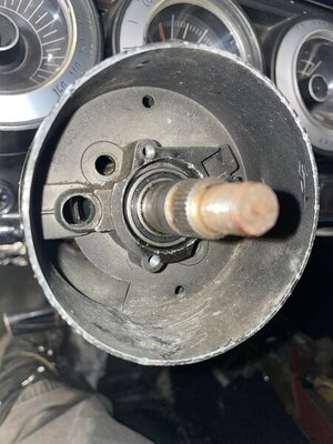

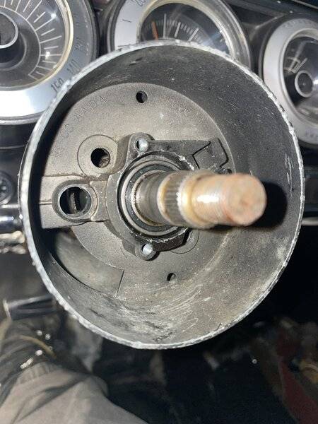

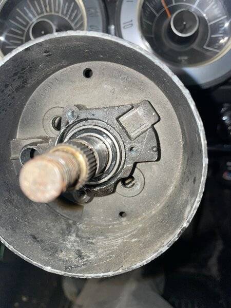

Well I ended up getting it but figured I’d post pictures anyways to complete the thread.
0CB34FD7-7B8E-47FD-A5BA-C5B174D1EE9D.jpeg 6AB908AA-AE9B-4CAB-9281-25829B35FBC8.jpeg
The bearing for whatever reason was stuck on the shaft and that little gap you see between the bearing in the housing was all I had to try and get a tool in there to pry on it.
ended up using two loops of wire and running it under the bearing in a cross pattern, then I wrapped the wire around a socket extension shaft and started spinning it taking out the slack, using the steering shaft as the pivot point… In essence kind of the same idea as a steering wheel puller. Don’t know how it worked exactly but it worked haha
