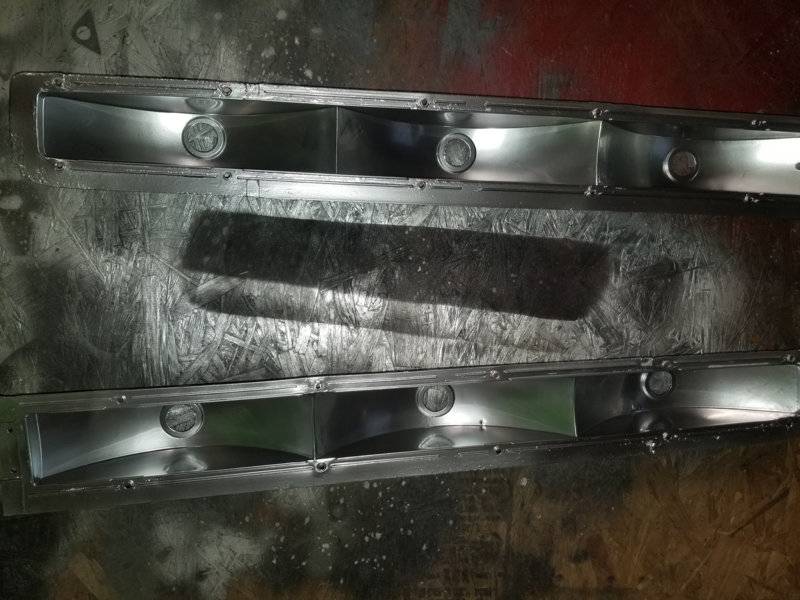

When I took mine apart, I cleaned the reflector side of the housing. Taped off the sockets, sprayed the the housing with high temperature chrome paint.

Hi 440 4 speed! Does the high temperature chrome paint work really well? My housing is old, but not bad looks like a dull silver actually. I guess you would get a nice light reflection if the housing was chrome
I used Rust-Oleum bright reflective metallic paint
