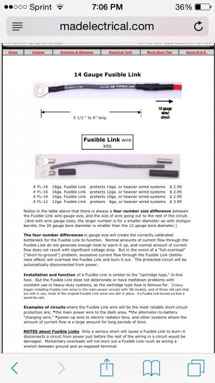

I didn't see one for a 65, just 66 and up. They may work, but I don't know if the gauges were different. Probably just the connectors?
Texas69Bee, thanks for the link. I have seen the MAD site. But I'm really thinking of switching to a fuse. Originality is not an issue and I don't like the idea of a wire that will just burn up.
