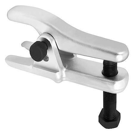

I’ve heard before about that center steering link being a BEAR to remove. Any additional *hints*, other than BFH? Lol. Does one use a *tie-rod folk* to separate the center link?

I use a separator like this to break steering links loose..tap it into place and turn the bolt with a 3/4" wrench. They pop right apart (sometimes with fury...be careful)

Tie rod fork works ok. Before I owned one, take two 2 lb hammers and smack both sides of center link where tie, pitmam etc tapers are. Nuts should loosened 5/6 turns first. Its like clapping hammers on the side of the tapers.

I will try that technique. Thanks!

Where can I get a “separator” like that?
Do you have a particular source & part number?

A buddy gave that to me, I don't think it was anything special..probably from napa or sonething?
