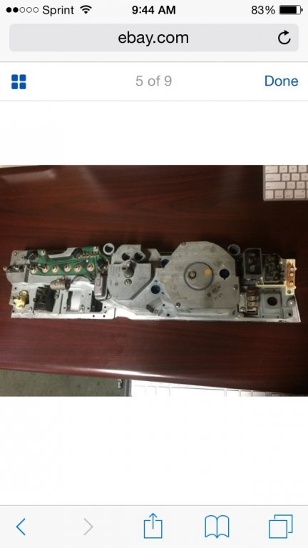

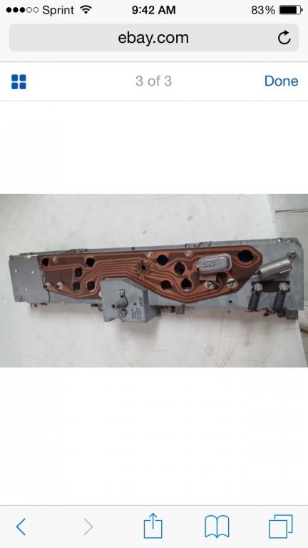

Someone have a pic of the back side of a 1968 instrument guage that they would post? Thanks...........................MO
These were on eBay. The first one is a non rally dash the second a rally dash.
