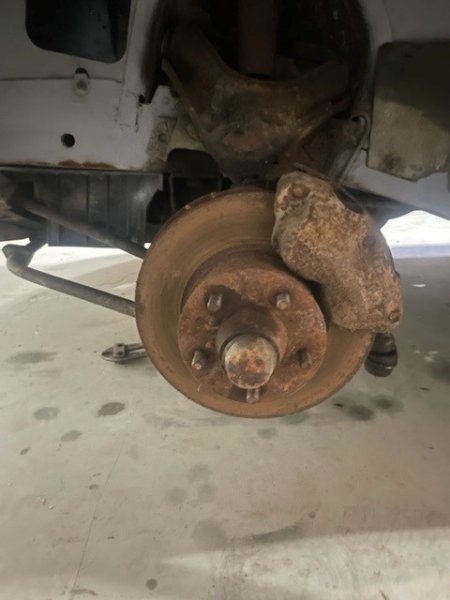

I recently acquired a 1969 charger SE, 383 car with factory front disc brakes. On my 68 I used Wilwood for everything, but I am not wanting to spend that kind of money on this car. Any suggestions on a good rotor/caliper brand that is more economical but still a good quality product? I am upgrading from 14" to 15" wheels on this car. Also, what do I need to verify to confirm I am buying something that is compatible with what's there now?

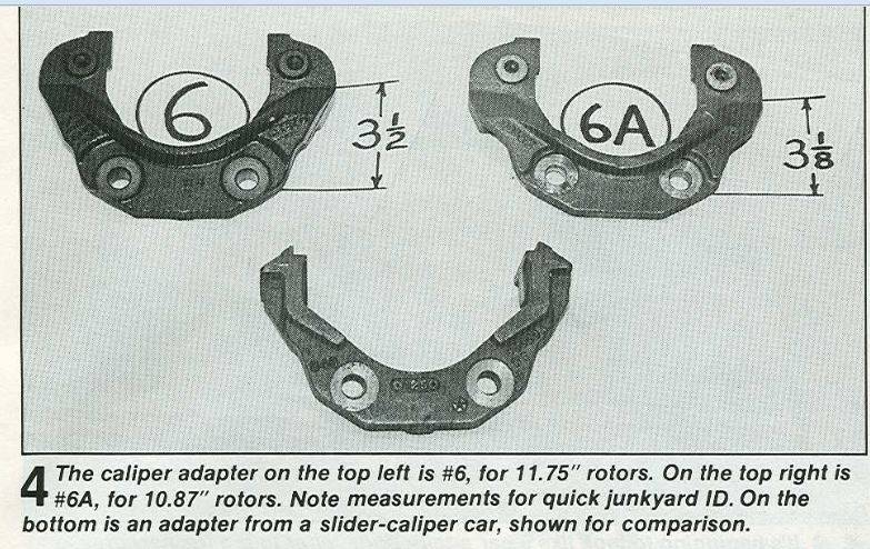

If you want the large 11.75 rotors, the caliper bracket are expensive. I took a picture of the two brackets and sent the picture to a junkyard in MI. Noted the ones I wanted, I had called them they said they had them. This was 2002 but might work still.

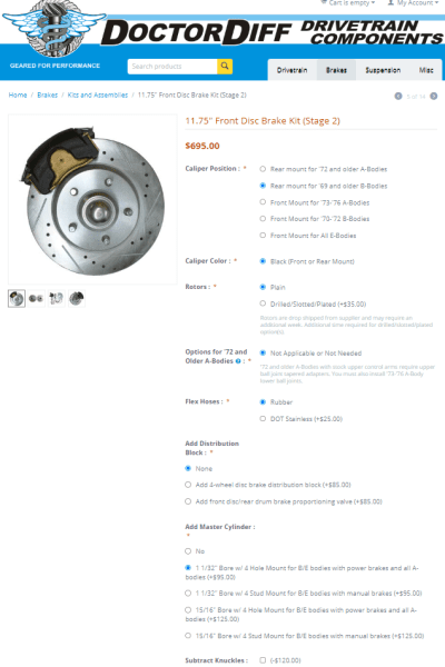

Here's a very stock looking Dr Diff kit with an upgrade to 11.75 rotors that will fit in 15" rims. Not much more $$ than the 10.75 rotor kit.
All wear and replacement parts found available at common parts stores.
