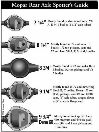

What will you use the car for? If street driving/cruising, Dana is way overkill. Look at the rear axle & figure out what it is. post a picture, crawl under it & get the casting numbers (on an 8 3/4 they're on the pinion housing behind the driveshaft. For performance use you want a limited slip (posi to the GM guys). You might find a used 8 3/4 pumpkin, otherwise a quality vendor is the way to go if you don't have the experience & tools. Good luck.

to start with know what you have

Finally got the car put of storage. Not sure which it is. Too round for the 7.25 I think.
Yep, you have an 8.25, which is fine unless you're making some HP monster engine. If you're just doing some basic performance upgrades, the 8.25 will handle that fine.
You can add a limited-slip capability to it, but I've never done one.
