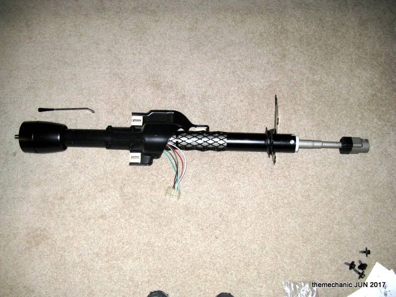

carefully remove and pull, the book reads to not hammer or force you will break the crash shears, pull it back in to the drivers seat I removed my power steering gear from under the car, had to put it back in from above by removing the exhaust manifold, I did not have a lift so raising it from under the car was too hard laying on my back, new manifold gasket , sealer on the stud an everything was normal. I my steering gear to: Stear and Gear, about 280.00 with shipping back in 2012

Pull the small pin out of the coupler that holds the blocks in. Pull the seal retainer off. Unbolt the column and pull the whole thing out of the coupler.
Now you can do whatever you want and take the coupler off at your leisure on the bench.
