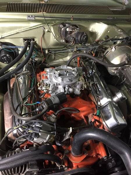

Car = Factory 69 383 Formula S 'Cuda.
32k miles, engine never been out AFAIK, but many leaks around the oil pan.
I'm trying to keep the car as original as possible, so not going to take engine out and clean things up "while I'm in there".
I'm definitely going to try and remove pan and R&R pan gasket.
May change rear main seal while in there.
Any tips on trying to install new main seal in an oily mess?
I shouldn't have to loosen main caps and "hope" crank drops a bit right?
Just remove rear main seal holder????
I know about offsetting the parting lines.
It's been > 40 years since I've been into a B engine, don't laugh but remind me which way the seal faces. Lip to harmonic damper or to flexplate?????
Thank you.
Engine shown below, rebuilt carb and funky dizzy cap, but shooting for how it may have looked in 1971
