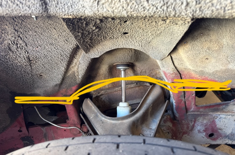

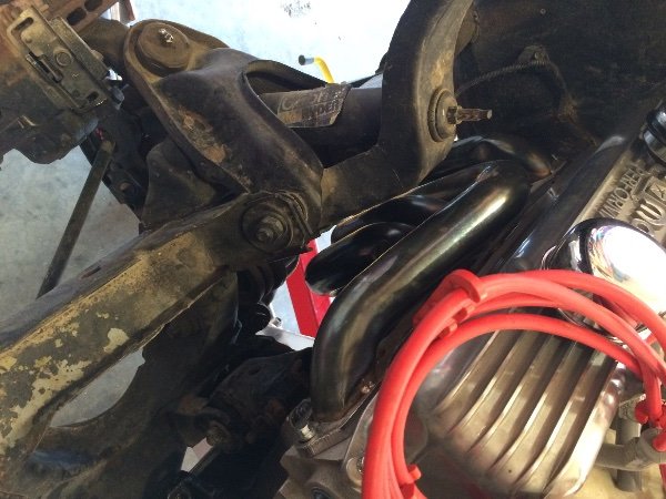

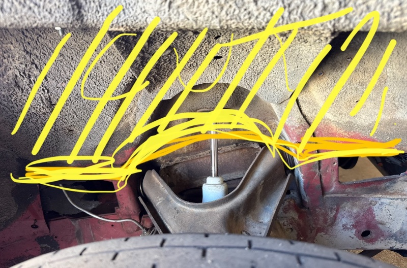

Race car application, who has removed their inner front fender? Would like to free up space in the engine bay and get rid of some of this junk however keeping stock suspension.
Plan is to run my 10-point roll cage bar typical routing through the firewall towards the front and bend downward by the radiator and then install a shock mount off of that for the shock.
Thinking I’ll fabricate a steel template that comes off the header so my shock mount tower is in the exact same location as where it sits now before I start cutting, which will give me exact shock location when it’s all disassembled.
I would cut the fender where it’s marked in the photo just above where the control arm mounts. The rest of the fender above would go completely away. I would keep the top rail for stronger mounting the actual fender, and fabricate arms with dzus to support the fender on the backside coming off the frame.
Thoughts from someone who has done this? Seems logical but would hate to screw up something I’m not thinking of.
13.0 car in 1/4 with race 440 going in it in the future.

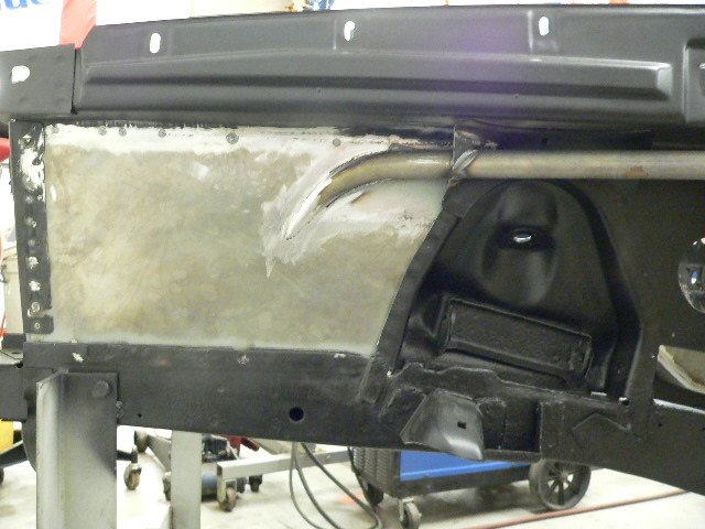

Any examples of what I think you are proposing is to leave the entire shock mounting area and weld the front down bars to the top of the rails and the shock mount, leaving the top and horizontal sections of the inner to bolt the outer fender to. Is that your plan? If so you will only gain a little weight loss at the expense of a weaker front end. Remember these are unibody cars.

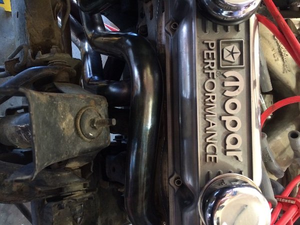

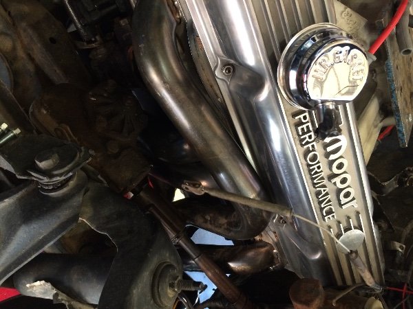

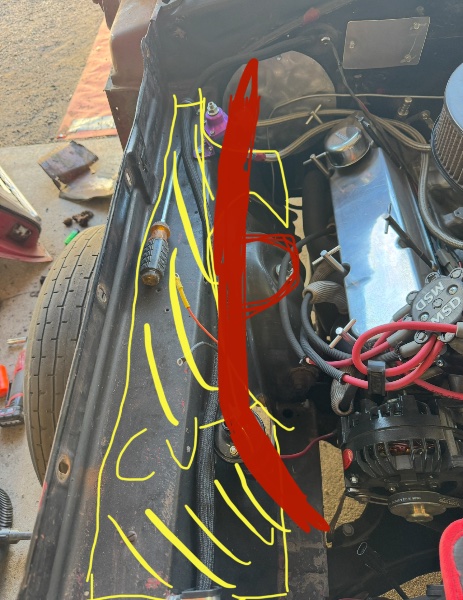

Picture from above and inside. Yellow would be cut. Red would be the 10-pt cage coming in. Shock mount would be on the cage. Many aftermarket mounts available.
If there’s any strength being given up, I think it’s made up with a cage bar running to the frame. This increases rigidity, drops weight and most importantly, frees up space in the bay.
I would consider keeping the top rail however Dad in the past has used aluminum angle as a stronger option.
The weight you remove isn't worth the amount of effort. The top of the shock tower is an integral part of the suspension. In fact if the car wheelies a lot that area needs to be reinforced. Mines been running long wheelies for 13 years. Body is still arrow straight. With no inners, mud, rubber get all over everything. Even leaving the fender splash shields off get the A pillars and hinges full of crap. Better places to lose weight. This car weighs 3125 empty and is all steel, except the hood, full interior minus the back seat.

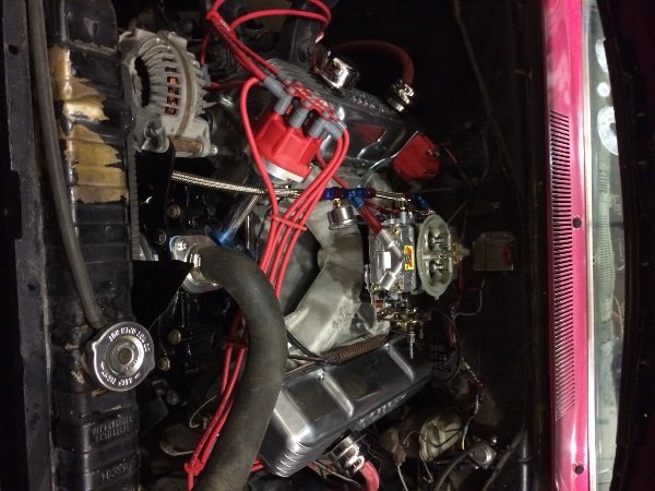

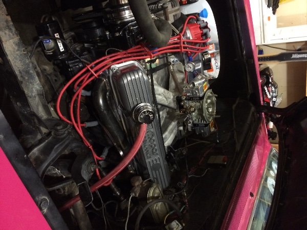

It’s less about the weight and more about access in the engine bay.
The ony thing that is tough is the #5 plug. And that due more to header design than the inner fenders. The motor can be out in 1 hour, trans in 30 minutes. We swapped a water pump in between rounds this summer in less than 10 minutes. What do you need to access that inner fender removal will help with? My fan and radiator assy come out with one plug, 2 bolts and the hoses. Everything in the front is then easily accessable. I learned long ago as a dealer tech. Taking off a few parts that are easy is way quicker and easier than struggling to remove something that is buried. Try to make stuff simple. Case in point. Look at the sideways carb linkage. No bell cranks and pivots. Simply a long aftermarket $20 cable and a 15 minute steel cable bracket. Or the fuel regulator mount. The carb plate is tapped 1/4-20 with one stud and a piece of tubing to space it out. Both are cheap, clean, and easy.
Doug

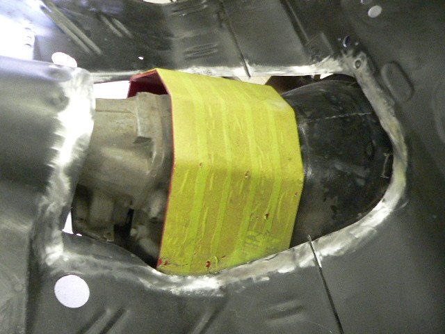

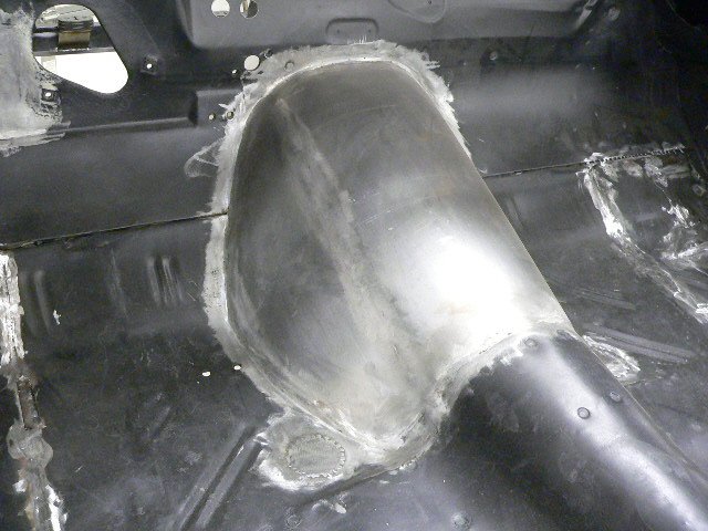

The two items that were a great help for access was pushing the firewall back and enlarging the trans tunnel. The firewall goes back pretty easy with a bottle jack and some wood across the the front of the firewall. The bottle jack on the K frame and a 4x4 betweeen the jack and firewall board. Move a little and move the board around. The tunnel enlargement makes using the standard TCI aluminum trans shield a breeze. Cut the hole at the front abouut 2" larger. Leave the rear of the tunnel at the trans crossmember and the throttle pedal mounting area. Then shove an oversized piece of sheet metal up in the hole. After tack welding (start at the top and work down). Trim the excess and finish weld. You cage looks nice.

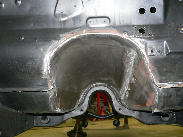

I’m in the midst of a project that has had me look at this. My takeaway is that given a Mopar B-Bodies construction, Removing the inner fenders is a lot of work with lots of down sides and very little if any upsides.
without the inner fender wells,
it will act like a parachute in ways catching air, under-hood
IMO, or in my experience, it's not the best for aerodynamics to remove them
maybe make them removeable, with a sheet of aluminum
Zeus fasteners/1/4 turn style, alum. sheet in place of them maybe so still removeable
that area needs the strength
or better be supported with some sort of tubing,
that part seems like you know already

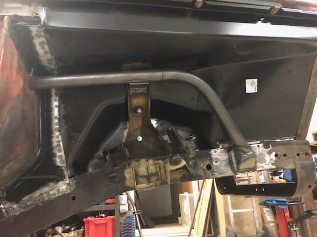

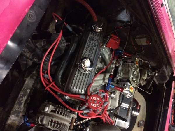

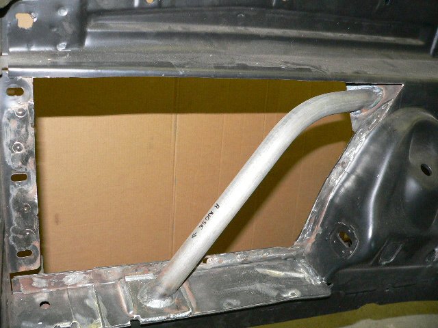

Here is my duster. Inners were already removed b4 I got it. It did have the bars attached to the shock tower but I removed them to run the big block with fenderwell headers when I first got it. It does have bars coming from the cage to the frame rail right behind the upper control arm mount. It is also welded to the ca mount as well as the rail. Kim
