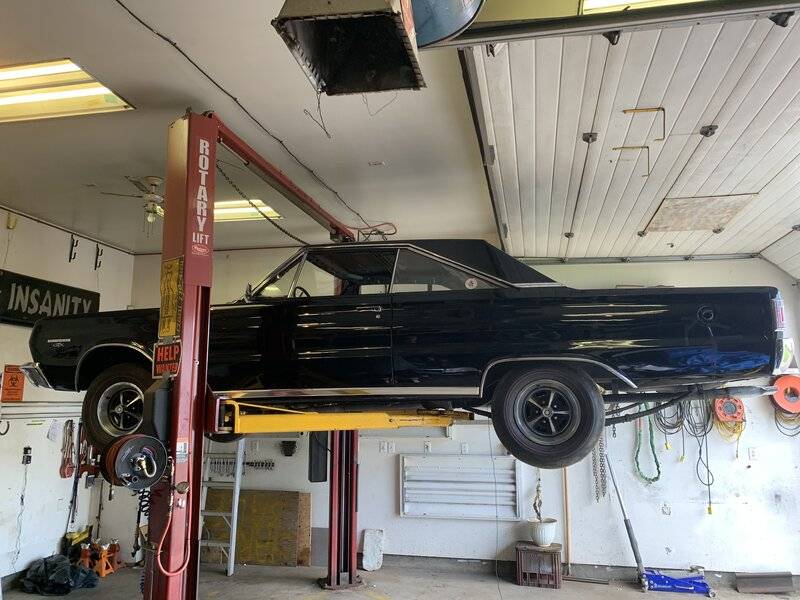

Replacing the scatter shield on a ‘78 Hemi GTX

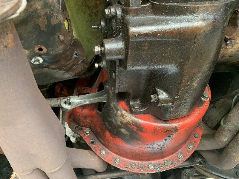

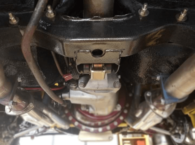

Brewers or Passon should have a reproduction bellhousing if you choose to go that route.

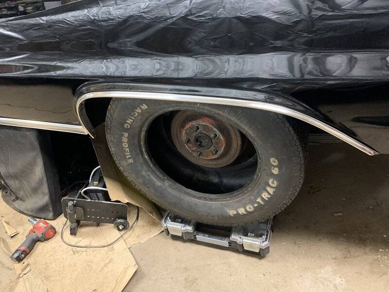

The L60’s will fit. Just need to order some Coker Magnums. Have F70 to match for the front.

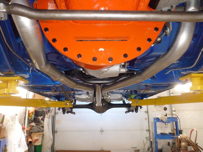

There's a reason it has a Lakewood scattersheild. Don't replace it. It won't devalue the car. Just buy a factory one and include it in the sale if you sell it.
I would never replace a scattershield with something less safe. If you have ever seen a flywheel explode, you wouldnt either. I have. Thankfully it wasn't mine.
I had a 727 lose a sprag and grenade on the line once. It had a TCI shield which I’m sure did save my foot. Thanks for the advice guys.
