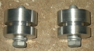

Here is a picture of the end of one on my 73 where you can see the bushing from the cross member to the body mount. I replaced with poly bushings.

I had steel bushings made at the machine shop and also 'boxed in' the cross member. Yes it is easier to do after unloading the torsion bars tho I cant see it being too much more difficult to do without unloading the bars as the tension is opposing so shouldnt move around too much if the xmember is still solid, just need a persuader of some sort just like doing the Kmember bushings lol

Do you still have the info on those steel bushings you had made. I think I might put my mill to work and make some.
