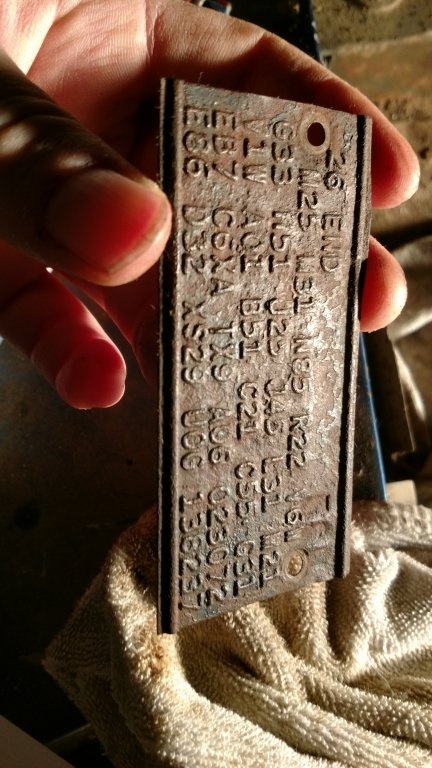

Yes I have the fender tag, but I didn't find a way to decode if it was an r/t-se or just an r/t. I can post a pic of the fender tag tomorrow if you guys think that may help.

Here's the tag. maybe you guys can be able to tell me if it's an r/t-se or not

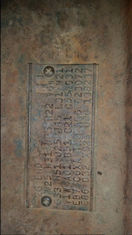

Well you should have found something out by now from the above reply #9.
'XS29' the 'S' makes it look like an R/T.
No 'A47' Special Edition Package which would give you Leather front seats (your tag shows vinyl seats C6XA), chrome trim around the go, stop and stay stopped peddles.
Your tag has some funny stamping on it.
One being the build date of what looks like 'A56', A = Oct. but Oct. does not have 56 days in it, it has to be a 0 or 1 or 2.
One being the 'UCG' the 'C' should be a '0'.

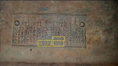

The shadows play tricks but SPD is Definitely A06 (October 6) and engine-year-plant is U0G
You are correct on the build date code and plant. The reason people have said it may be an R/t SE is the fact of rocker molding, factory a/c and pretty sure it has a slight green tint to glass from what I've gathered. Either way it is a good find.

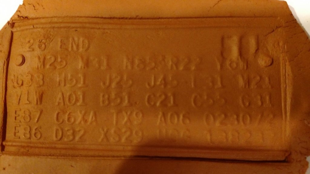

I would like to see a larger clearer picture of the fended tag please.
Yes, a very good find, there still out there.
Here's the best ATM. I'm gonna try to make an impression in clay later to see if it will pull it in clearer
Put your info into a site I was given yesterday
