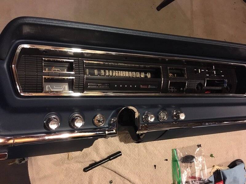

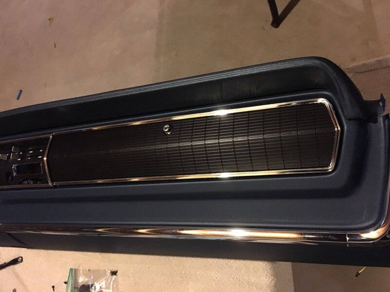

A few years ago I sent my core out to be redone. For some reason I can’t fingers out who did it. I know it went AZ. Anyway, they did a great job and recovered the steel core. Came back the color I ordered. I pulled the pad and reinstalled when the dash was out.
