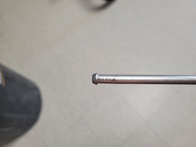

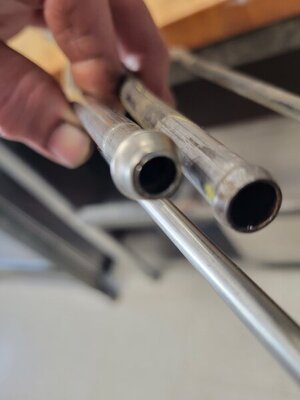

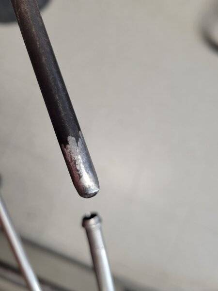

Have you ever looked at how bad the ends are finished on these, quite the restriction. Right is factory 3/8, left is fine lines 3/8 stainless.
I seeeeeee! Trim the end back until you get the right diameter.
Who's are those??? My repros certainly didn't look like that.. from The Right Stuff...
I would call them. They look like ****. Are all the ends like that? If so send the junk back.

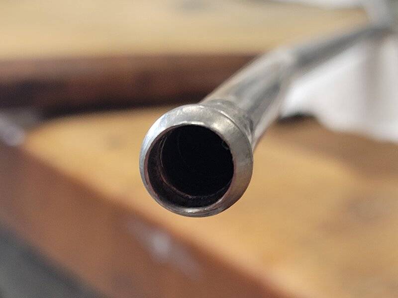

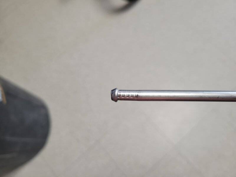

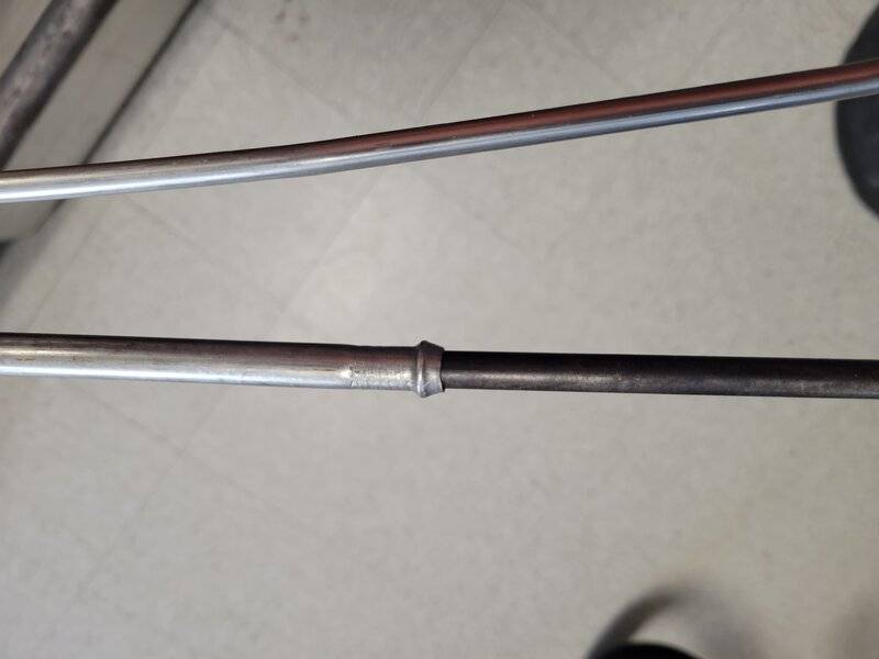

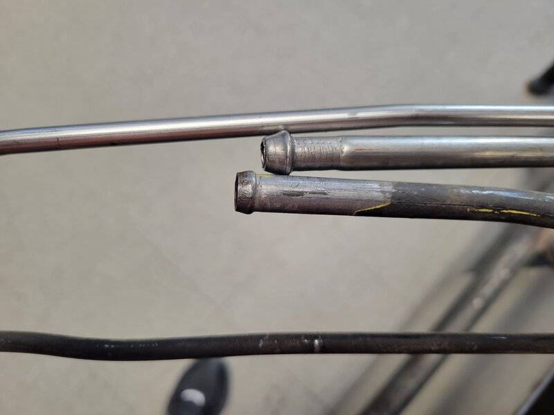

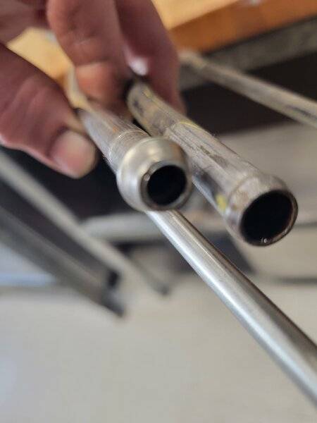

Fine lines, cut the tip and polished up a pushrod to knock the swage out. Return is not much better.
A little bigger than original now. Could be one of the reasons restorations run like such dogs.
