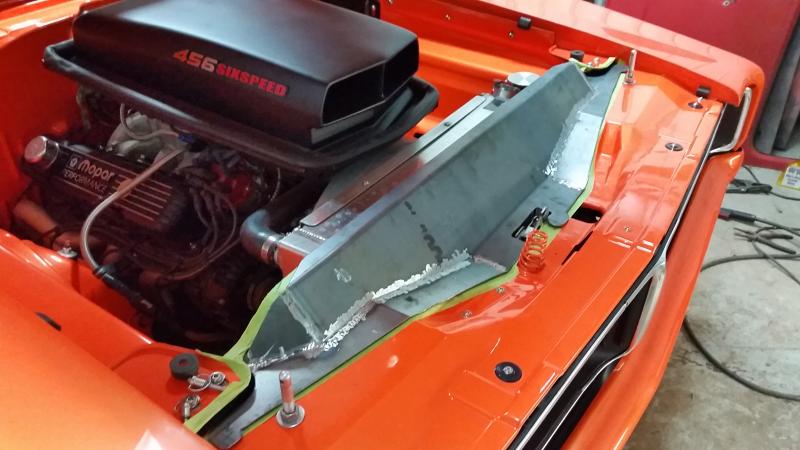

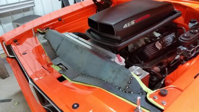

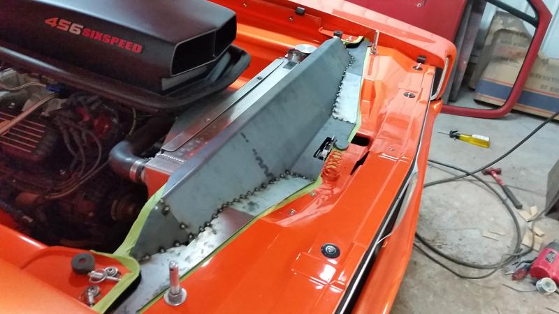

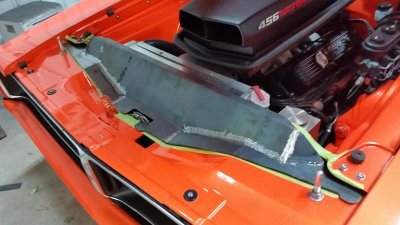

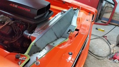

I had to use the search engine to even find this thread haha..... I got bored last night and fixed an eye sore that's been bugging me. I can't stand that huge opening above the radiator that leaves all the headlight wiring, radiator, etc out in the opening so it's no longer there...... after I paint it of coarse. All I had to work with for template material was thick cardboard so that was honestly the hardest part, other than that I knocked it out in about 2hrs. It's made of 5 pieces then tacked in place while on the car and then welded solid from the rear, pretty simple.

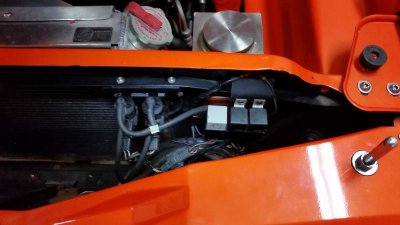

I should have added that the sudden urge to get this done was because I finally wired my headlight buckets to open automatically.....I've been opening them manually. I used Ford solenoid operated vacuum valves to accomplish the job eliminating all of the messy vacuum hoses going threw the firewall and the expensive headlight switch as well. Of coarse it was all ended up being mounted right by the radiator adding to the clutter so it was time to do it.
I like it! I'm wondering if I could make one out of aluminum.. What's the plan for attaching it? Stainless button heads like elsewhere?
