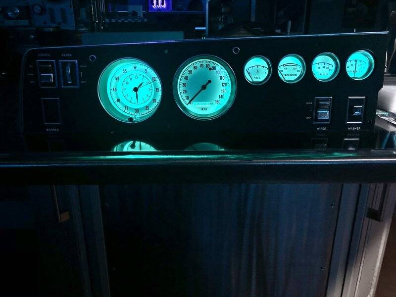

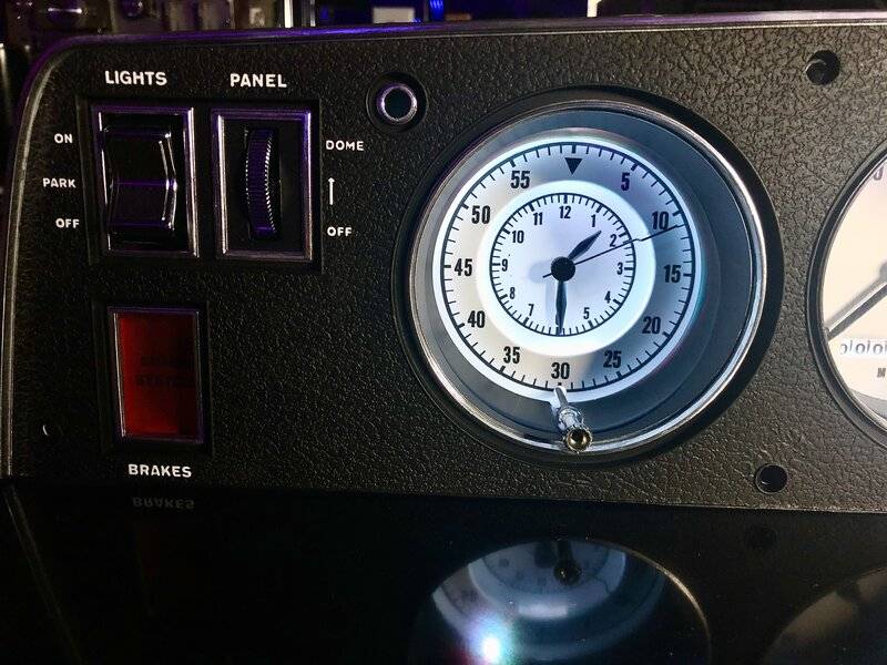

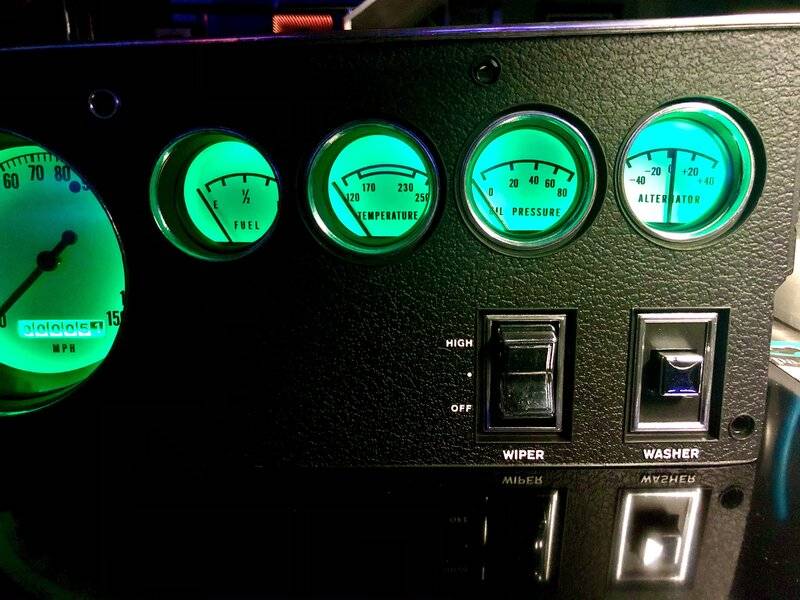

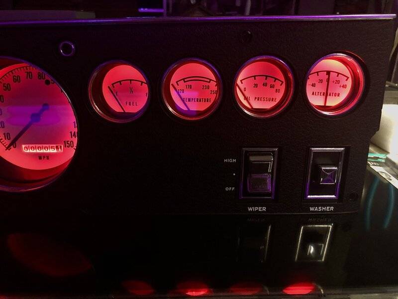

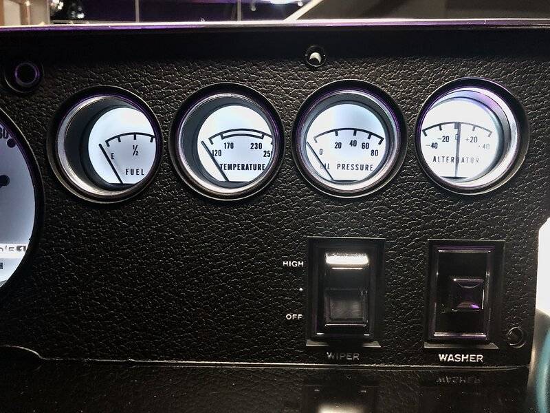

Just finished with a beautiful 1970 Rallye Gauge Cluster for a FBBO member. This Cluster received a full restoration with two stylish modifications. The first modification is the premium white gauge overlays. The entire face of each gauge was stripped of original coatings and white was applied. The overlays blend into the white nicely. Each needle was sanded and blacked out for excellent contrast. The second modification was adding an internal (integrated) LED RGB(red, green,blue) lighting source that is controlled by a simple mini controller that can be mounted out of sight. The color choice is unlimited and has varying degrees for dimming. The LED system can easily be connected to either switched or unswitched with a simple ground and positive connection. The original dash switches and lighting system work as the factory intended. The LED's do NOT get hot, they consume minimal power and will last for 50k hours of run time. If you have questions or are interested, please PM me. Thanks, Steve
