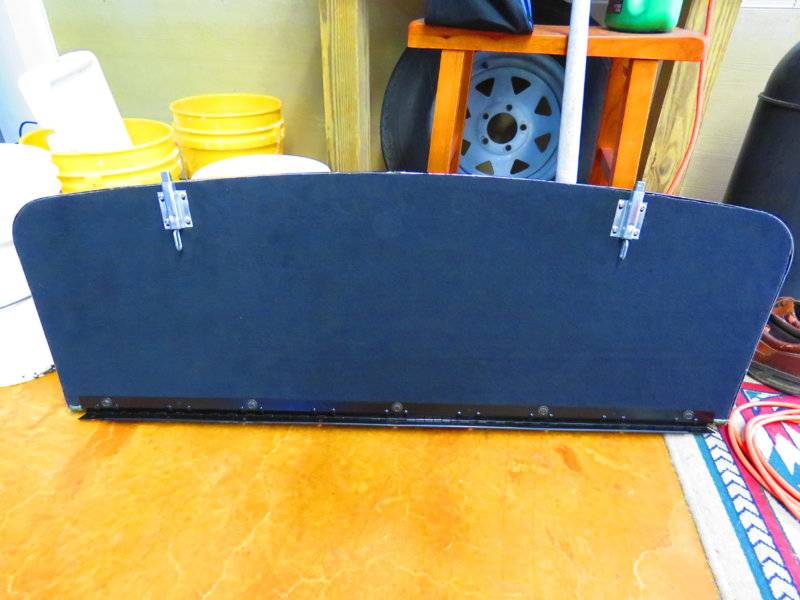

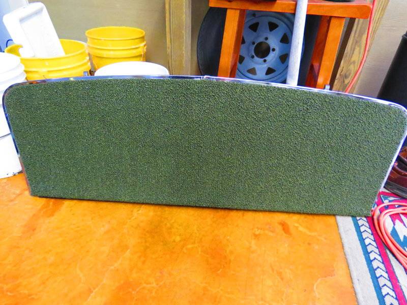

Did anyone notice the fine felt like material on the trunk side of the divider. It stumped me for weeks trying to figure out how to get that original look. I took the divider board to several upholstery shops and to fellow car enthusiasts and nobody could offer a good solution. So anyway, I ended up buying a piece of swede, and used the backside of the swede (glued the good side to the board). It looks great. Then, only two days later, this guy tells me about the flocking process. Low and behold, I believe they originally flocked the backside of the board. Dang it.
Now to the carpet side: The original carpet was folded over the bottom edge to the backside (trunk side) and the piano hinge was bolted down on top of the carpet. No carpet was showing above the piano hinge. On the bottom edge there were several (about eight to ten) small staples holding the carpet to the bottom edge. I didn't see any overlap of carpet on the sides and top of the plywood board -- mine was trimmed flush to the wood.

Rear divider pics
