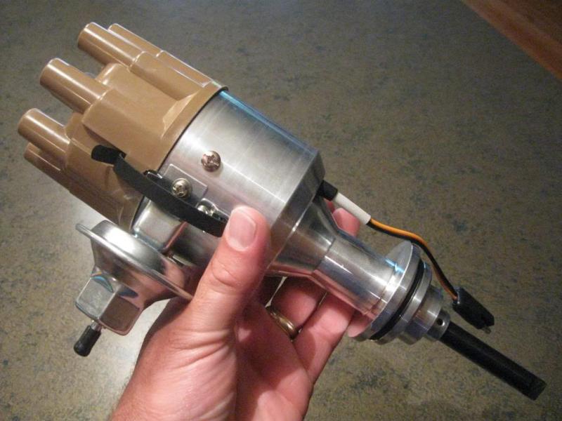

I installed the Pertronix III dist with their Blaster coil in my 69 Coronet, stock 440. I only drove the car for a week after install before crashing (sigh) and it's been in rebuild mode ever since, but it ran fine for the short time I used it. The install was straight forward, easy wiring 'cause it eliminates the ballast resistor and control box. It has a rev limiter too. But because the brains are inside the dist housing it's a larger diameter so I had to grind down a little of the stock head to get it to fit. Below is my original thread:
http://www.forbbodiesonly.com/moparforum/showthread.php?61286-Pertonix-won-t-fit!

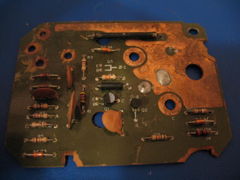

The orange box is just and transistorized switch in place of the points, the box basically detects the magnetic pulse from the distributor, and turns the output transistor off (the normal state is the transistor is on, so it will be pulling current through the coil when the engine is not spining.) The box has a timing circuit that sets how long the transistor is off to create a dwell angle. It also has an internal zener diode voltage reference with a power resistor inside the box (that is why the orange box is 4-pin compared to the older 5-pin unit that had the resistor outside the box.
Picture of an orange box circuit card
