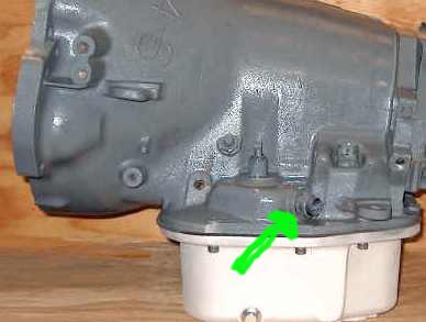

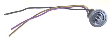

It's really easy. I've attached a photo of a 727 - the arrow shows you where the NSS is. I've also attached a photo of the connector. All you have to do is pull it off, replace the NSS and plug it back in. You probably will have some tranny fluid drain out, so be prepared. Also, check the connections are clean. If they are fugly, just spray a little vinegar and salt mixture on them, wait like 30 seconds, then clean thoroughly, spray with some non conducting electrical lube (or slather some silicone based lube on) and pop the connector back on. Also, the new NSS should have an aluminum crush washer on it to help it seal - make sure the old one is removed before putting the new on one, or it might leak.

The middle terminal completes a ground for the neutral safety, the outer 2 are a switch for the reverse lights. Sure sounds like the switch is working just not when it's supposed to, you said it happened after being serviced.... what did you have done?
